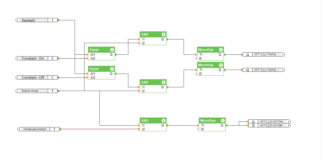

Loxone can send values and result to a group address on ETS bus, is it also possible to read groupaddress from Loxone? Example: I have a function Day/Night that is used to let the MDT glasstaster known its day or night. For this i'm sending on regular base all groupmembers the value true or false.
My MDT actors have also some logic functions, but when using the logic function there's a read send to the group address where in a normal scenario the groupmember responsible for read response with the requested value.
In screenshot an example how i send on regular base the day/night en time/date values to the corresponding group address. Any way / trick to trigger this function when a read request is retrieved?
