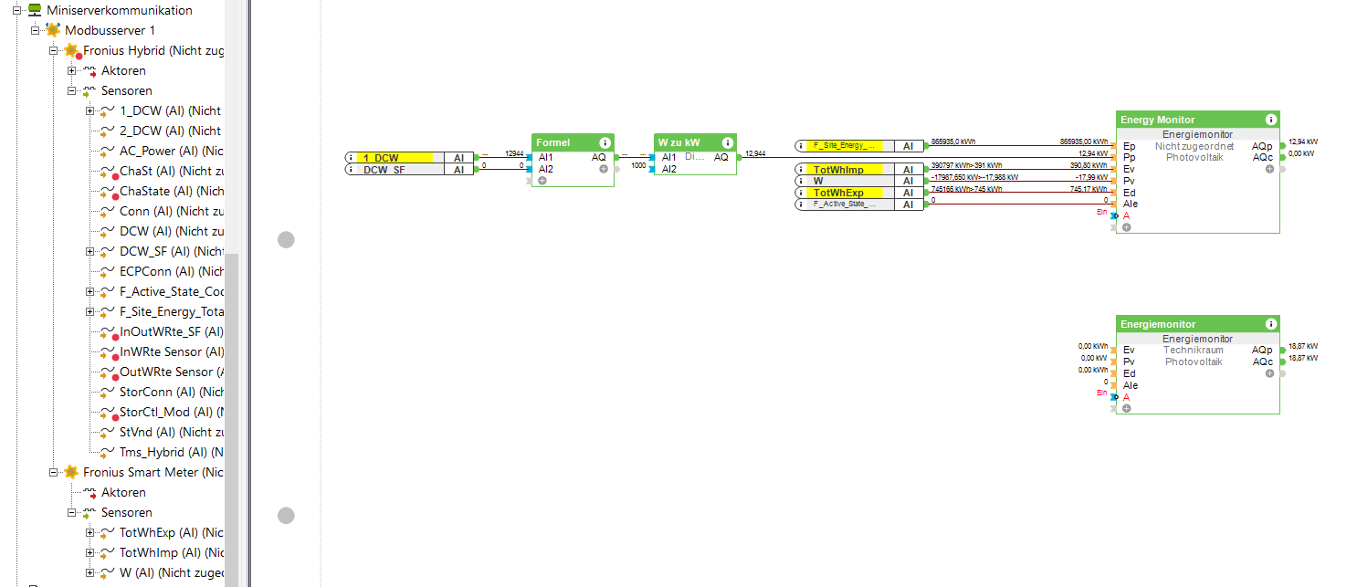

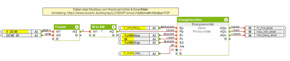

      Since there is no battery in my setup (only Symo 4.5.3 and SmartMeter), I think I can simplify the logic as you can seen in my screenshot, but I'm not sure. I have to check it again tomorrow, when energy is produced.

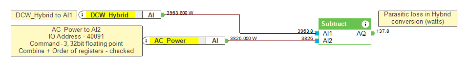

              You may find that the Symo 20 uses a different Modbus register for the total power. There are two options -
              DCW - Total DC power from the system.
              AC_Power - Total AC power from the system.
              The 'AC_Power' sensor works for both Symo 20 and Hybrid inverters (Fronius uses 1_DCW for the solar Production display of the Hybrid).
              Klicke auf die Grafik für eine vergrößerte Ansicht  Name: Parasitic loss.png Ansichten: 0 Größe: 17,8 KB ID: 239060
              Use whichever value more closely matches the Fronius solar Production display for the Symo 20. Most likely it will be AC_Power.

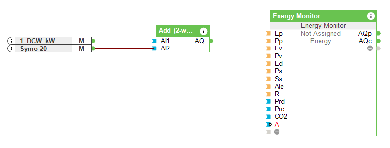

                  • Tico
                    • 31.08.2016
                    • 1035
                    The Symo 20 is added to the Hybrid solar production, then into input Pp. The other connections in the image are omitted for clarity only.

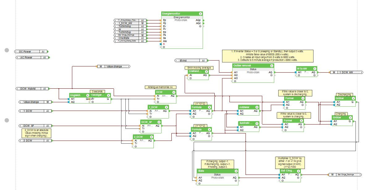

                          I tried to adapt the template based on my needs (no hybrid, no battery).
                          Here is my current status:
                          Klicke auf die Grafik für eine vergrößerte Ansicht  Name: PV.png Ansichten: 0 Größe: 86,7 KB ID: 243024
                          I can't get a connection to the Fronius Inverter (status red).
                          What could be the reason, someone an idea?
                          ​​​​​​​Are these the values that comes only from a hybrid inverter?
                          Zuletzt geändert von Goofy; 04.04.2020, 13:59.
                          • Tico
                            • 31.08.2016
                            • 1035
                            #29
                            Yes, the following are values purely for the Hybrid inverter/battery (all the red dots) -
                            ChaSt
                            ChaState
                            InOutWRte_SF
                            InWRte
                            OutWRte
                            StorCtl_Mod
                            I suggest you delete them entirely. You might find the inverter won't show an error after they are deleted and the Config saved. All your values seem fine otherwise.
