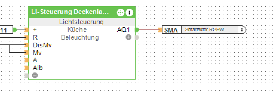

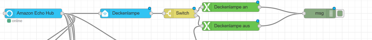

      Deckenlampe Ceiling Light ein/ausschalten
      Flow
      [{"id":"76b4aaa5.0a2964","type":"amazon-echo-hub","z":"941423fb.098f9","port":"8080","x":110,"y":60,"wires":[["e354b65.c83adc8","cc5238bf.f2095","86c7529a.a9eb98","53a507e0.4180a8","1e3109ab.f64c7e","2502efdb.fba7e","62131ec5.87988","53ba60ba.d5b46","e742ac32.61a9a8","5ac7ed3a.227054"]]},{"id":"7dd9b0f3.edb6c","type":"debug","z":"941423fb.098f9","name":"","active":true,"tosidebar":true,"console":false,"tostatus":false,"complete":"true","targetType":"full","x":1010,"y":60,"wires":[]},{"id":"e354b65.c83adc8","type":"amazon-echo-device","z":"941423fb.098f9","name":"Deckenlampe","topic":"","x":400,"y":60,"wires":[["7a804799.4c46b"]]},{"id":"1580d22c.26e60e","type":"loxone-webservice","z":"941423fb.098f9","name":"Deckenlampe an","miniserver":"66bf7eb5.449fc","uri":"jdev/sps/io/LI-Deckenlampe/AI1/1001000100000","appendpayload":false,"x":730,"y":40,"wires":[["7dd9b0f3.edb6c"]]},{"id":"75f299c2.8d5e2","type":"loxone-webservice","z":"941423fb.098f9","name":"Deckenlampe aus","miniserver":"66bf7eb5.449fc","uri":"jdev/sps/io/LI-Deckenlampe/changeTo/778","appendpayload":false,"x":730,"y":100,"wires":[["7dd9b0f3.edb6c"]]},{"id":"7a804799.4c46b","type":"switch","z":"941423fb.098f9","name":"","property":"payload","propertyType":"msg","rules":[{"t":"eq","v":"on","vt":"str"},{"t":"eq","v":"off","vt":"str"}],"checkall":"true","repair":false,"outputs":2,"x":570,"y":60,"wires":[["1580d22c.26e60e"],["75f299c2.8d5e2"]]},{"id":"66bf7eb5.449fc","type":"loxone-miniserver","z":"","host":"192.168.178.77","port":"11111","enctype":"0","active":true}]
      Weitere Beispiele:
      66 % dimmen und Kaltweiß
      jdev/sps/io/LI-Deckenlampe/AI1/temp(66,6500)
      100 % und Warmweiß
      jdev/sps/io/LI-Deckenlampe/AI1/temp(100,2700)

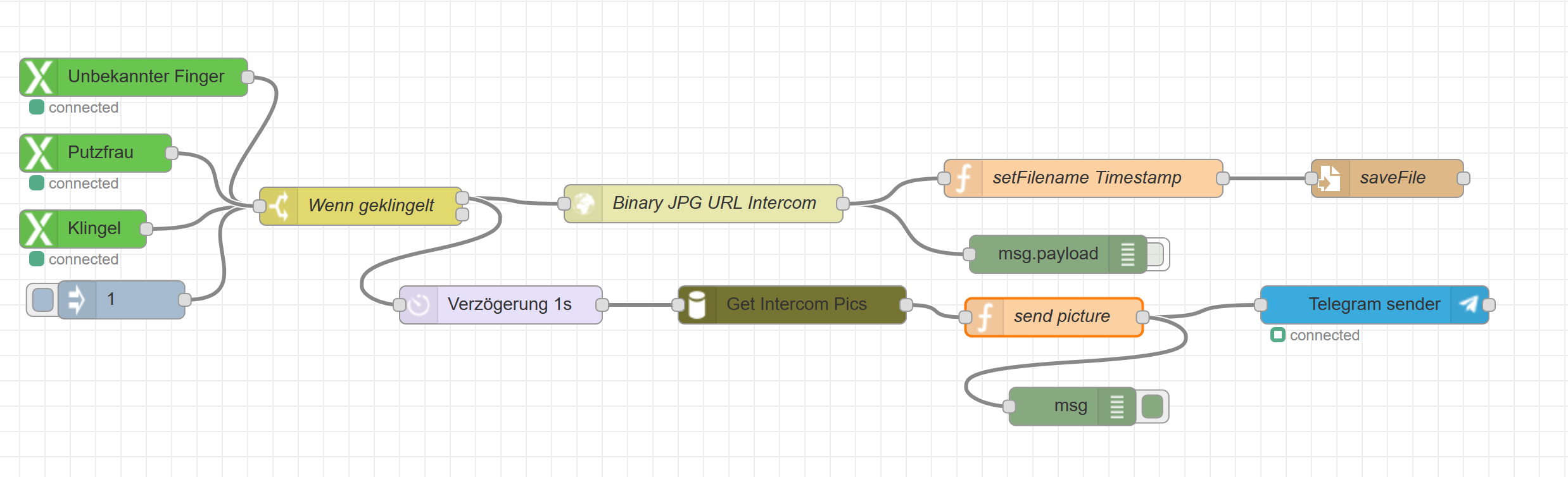

        Klingelbild der Intercom per Telegram
        [{"id":"f20f61bd.8f7bf8","type":"file","z":"28ee97d4.83ac78","name":"saveFile","filename":"","appendNewline":false,"createDir":false,"overwriteFile":"true","x":1120,"y":180,"wires":[[]]},{"id":"aabd6663.d34568","type":"debug","z":"28ee97d4.83ac78","name":"","active":false,"console":"false","complete":"false","x":860,"y":240,"wires":[]},{"id":"b9d132f6.e607b8","type":"http request","z":"28ee97d4.83ac78","name":"Binary JPG URL Intercom","method":"GET","ret":"bin","url":"http://192.168.178.99/jpg/image.jpg","tls":"","x":580,"y":200,"wires":[["aabd6663.d34568","4cd83d31.213a7c"]]},{"id":"4cd83d31.213a7c","type":"function","z":"28ee97d4.83ac78","name":"setFilename Timestamp","func":"    var now     = new Date(); \n    var year    = now.getFullYear();\n    var month   = now.getMonth()+1; \n    var day     = now.getDate();\n    var hour    = now.getHours();\n    var minute  = now.getMinutes();\n    var second  = now.getSeconds(); \n    if(month.toString().length == 1) {\n    var month = '0'+month;\n    }\n    if(day.toString().length == 1) {\n    var day = '0'+day;\n    }   \n    if(hour.toString().length == 1) {\n    var hour = '0'+hour;\n    }\n    if(minute.toString().length == 1) {\n    var minute = '0'+minute;\n    }\n    if(second.toString().length == 1) {\n    var second = '0'+second;\n    }   \n    msg.timestamp = year+'-'+month+'-'+day+' '+hour+'-'+minute+'-'+second;\n\nmsg.filename = \"/var/www/html/intercom/\" + msg.timestamp + \".jpg\";\nreturn msg;","outputs":1,"noerr":0,"x":880,"y":180,"wires":[["f20f61bd.8f7bf8"]]},{"id":"2e161018.47647","type":"loxone-control-in","z":"28ee97d4.83ac78","name":"Klingel","miniserver":"2fc45623.c6790a","control":"0ef6a03d-03b4-06ac-fffffc17f0d60351","state":"0ef6a03d-03b4-06a8-ffff3574c0b48382","x":90,"y":220,"wires":[["a6b38713.504f38"]]},{"id":"a6b38713.504f38","type":"switch","z":"28ee97d4.83ac78","name":"Wenn geklingelt","property":"payload","propertyType":"msg","rules":[{"t":"eq","v":"1","vt":"str"},{"t":"neq","v":"1","vt":"str"}],"checkall":"true","repair":false,"outputs":2,"x":309.5,"y":202.00003051757812,"wires":[["b9d132f6.e607b8","149e4ec9.274999"],[]]},{"id":"91ad9fda.ccfe18","type":"telegram sender","z":"28ee97d4.83ac78","name":"","bot":"1511ad21.103203","x":1110,"y":280,"wires":[[]]},{"id":"c306e851.90504","type":"function","z":"28ee97d4.83ac78","name":"send picture","func":"let data = msg.payload;\nmsg.file = msg.files[msg.files.length -1];\nlet msg1 = {};\nnode.warn(msg.file);\n//msg1.payload.options = {disable_web_page_preview : true};\nmsg1.payload = {\n\t    chatId: -1234,\n        type: \"photo\",\n        content: '/var/www/html/intercom/' + msg.file\n\t}\nreturn msg1;\n\n/* type can be one of the following\nphoto\naudio\nvideo\nsticker\nvoice\ndocument\n*/","outputs":1,"noerr":0,"x":856.75,"y":289.75,"wires":[["91ad9fda.ccfe18","72318da.1ba4d74"]]},{"id":"ba4a8ef4.6c0048","type":"fs-ops-dir","z":"28ee97d4.83ac78","name":"Get Intercom Pics","path":"/var/www/html/intercom/","pathType":"str","filter":"*.jpg","filterType":"str","dir":"files","dirType":"msg","x":650,"y":280,"wires":[["c306e851.90504"]]},{"id":"149e4ec9.274999","type":"delay","z":"28ee97d4.83ac78","name":"","pauseType":"delay","timeout":"1","timeoutUnits":"seconds","rate":"1","nbRateUnits":"1","rateUnits":"second","randomFirst":"1","randomLast":"5","randomUnits":"seconds","drop":false,"x":420,"y":280,"wires":[["ba4a8ef4.6c0048"]]},{"id":"162d5be.8427d24","type":"inject","z":"28ee97d4.83ac78","name":"","topic":"","payload":"1","payloadType":"num","repeat":"","crontab":"","once":false,"onceDelay":0.1,"x":120.36666870117188,"y":276,"wires":[["a6b38713.504f38"]]},{"id":"72318da.1ba4d74","type":"debug","z":"28ee97d4.83ac78","name":"","active":true,"tosidebar":true,"console":false,"tostatus":false,"complete":"true","targetType":"full","x":871.36669921875,"y":360.25,"wires":[]},{"id":"798e15.f51dc1ec","type":"loxone-control-in","z":"28ee97d4.83ac78","name":"Unbekannter Finger","miniserver":"2fc45623.c6790a","control":"10cac51f-031a-e24f-fffffc17f0d60351","state":"10cac51f-031a-e24f-fffffc17f0d60351","x":130,"y":100,"wires":[["a6b38713.504f38"]]},{"id":"f8d9d1c3.2e38d","type":"loxone-control-in","z":"28ee97d4.83ac78","name":"Putzfrau","miniserver":"2fc45623.c6790a","control":"12d466ab-038f-1659-fffffc17f0d60351","state":"12d466ab-038f-1659-fffffc17f0d60351","x":100,"y":160,"wires":[["a6b38713.504f38"]]},{"id":"2fc45623.c6790a","type":"loxone-miniserver","z":"","host":"192.168.178.77","port":"11111","enctype":"0","active":true},{"id":"1511ad21.103203","type":"telegram bot","z":"","botname":"Botname","usernames":"xyz","chatids":"-1234","baseapiurl":"","pollinterval":"1000","usesocks":false,"sockshost":"","socksport":"","socksusername":"","sockspassword":"","bothost":"","localbotport":"","publicbotport":"","privatekey":"","certificate":"","useselfsignedcertificate":false,"verboselogging":false}]
        • Triss-1
          Triss-1 kommentierte
          Vielen Dank, dank deiner Hilfe habe ich alles zum Laufen bekommen!
        • Xenobiologist
          Xenobiologist kommentierte
          Perfekt!

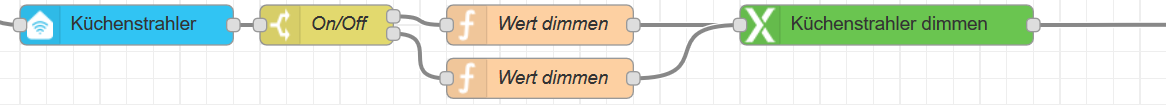

            Lampe dimmen
            Ggf. noch wichtig. Der Befehl in der URI muss encoded wenn Sonderzeichen enthalten sein. Also Leerzeichen = %20 usw.
            HTML-Code:
            [{"id":"d2414bba.328ae8","type":"loxone-webservice","z":"14b94bbc.fe858c","name":"Küchenstrahler dimmen","miniserver":"66bf7eb5.449fc","uri":"jdev/sps/io/LI-Steuerung%20K%C3%BCche/AI4/","appendpayload":false,"x":830,"y":540,"wires":[["41e751e3.f1e258"]]},{"id":"4edf4d2f.9957e4","type":"amazon-echo-device","z":"14b94bbc.fe858c","name":"Küchenstrahler","topic":"","x":260,"y":540,"wires":[["79abc0d7.3e4a8"]]},{"id":"26702ca8.7999fc","type":"function","z":"14b94bbc.fe858c","name":"Wert dimmen","func":"msg.uri = 'jdev/sps/io/LI-Steuerung%20K%C3%BCche/AI4/' + msg.percentage;\nreturn msg;","outputs":1,"noerr":0,"x":570,"y":540,"wires":[["d2414bba.328ae8"]]},{"id":"79abc0d7.3e4a8","type":"switch","z":"14b94bbc.fe858c","name":"On/Off","property":"payload","propertyType":"msg","rules":[{"t":"eq","v":"on","vt":"str"},{"t":"eq","v":"off","vt":"str"}],"checkall":"true","repair":false,"outputs":2,"x":410,"y":540,"wires":[["26702ca8.7999fc"],["4a1370c6.3ef7f8"]]},{"id":"4a1370c6.3ef7f8","type":"function","z":"14b94bbc.fe858c","name":"Wert dimmen","func":"msg.uri = 'jdev/sps/io/LI-Steuerung%20K%C3%BCche/AI4/0';\nreturn msg;","outputs":1,"noerr":0,"x":570,"y":580,"wires":[["d2414bba.328ae8"]]},{"id":"66bf7eb5.449fc","type":"loxone-miniserver","z":"","host":"192.168.178.77","port":"12345","enctype":"0","active":true}]
            • Negropo
              Negropo kommentierte
              Hallo und vielen Dank für die Zusammenstellung. Ich hatte es schon einmal mit dem node alexa-local probiert und eine Funktion gefunden mit der ich on/off/dim gut umsetzen konnte. Leider funktioniert das Setting mit den Echo's der 2nd Gen nicht, so dass ich jetzt auf den von dir genannten node umsteige.
              Das Problem ist jedoch, dass hier keine Unterscheidung zwischen on_off_command stattfindet, also er sich quasi die percentage des dimmens merkt und bei einem erneuten "ein" wieder auf den alten Dimm-Wert zurückgreift. Ich hätte gern, dass er bei einem "ein" immer auf 100% Helligkeit geht.
              Hast du eine Idee, wie man das umsetzen kann?
              Vielen Dank und beste Grüße
              Negropo
            • Xenobiologist
              Das ist einfach zu lösen. Siehe hier https://www.loxforum.com/forum/faqs-...218#post226218
              Einfach einen node dazwischen hängen, als Weiche für on/off

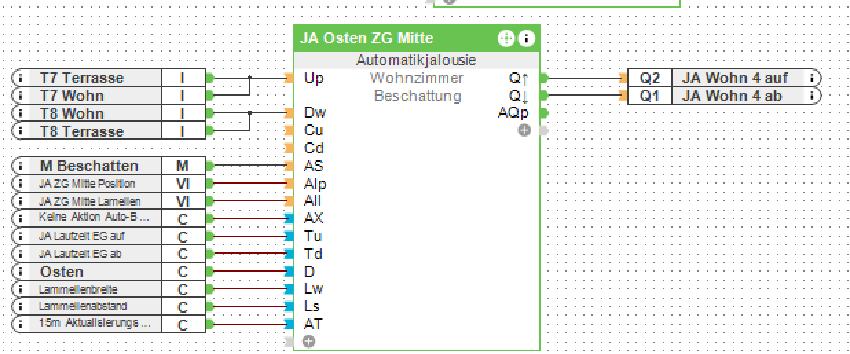

            Rolläden und Raffsotren
            [CODE][{"id":"42d53e67.b4cf7","type":"loxone-webservice","z":"ab05d86.e4cb3a8","name":"JA Mitte Up","miniserver":"66bf7eb5.449fc","uri":"jdev/sps/io/JA%20Osten%20ZG%20Mitte/Up","appendpayload":false,"x":650,"y":100,"wires":[["dcbf8161.bf757"]]},{"id":"dcbf8161.bf757","type":"debug","z":"ab05d86.e4cb3a8","name":"","active":false,"console":"false","complete":"false","x":877.142822265625,"y":68.28573608398438,"wires":[]},{"id":"ead0ab3c.a824","type":"loxone-webservice","z":"ab05d86.e4cb3a8","name":"JA Mitte Down","miniserver":"66bf7eb5.449fc","uri":"jdev/sps/io/JA%20Osten%20ZG%20Mitte/Down","appendpayload":false,"x":652.28564453125,"y":32.571434020996094,"wires":[["dcbf8161.bf757"]]},{"id":"dc66436c.ce99c8","type":"switch","z":"ab05d86.e4cb3a8","name":"On/Off","property":"payload","propertyType":"msg","rules":[{"t":"eq","v":"on","vt":"str"},{"t":"eq","v":"off","vt":"str"}],"checkall":"true","outputs":2,"x":472.142822265625,"y":72.28573608398438,"wires":[["ead0ab3c.a824"],["42d53e67.b4cf7"]]},{"id":"eafd13af.b974e","type":"amazon-echo-device","z":"ab05d86.e4cb3a8","name":"Mitte","topic":"","x":310,"y":80,"wires":[["dc66436c.ce99c8"]]},{"id":"66bf7eb5.449fc","type":"loxone-miniserver","z":"","host":"192.168.178.77","port":"1111","enctype":"0","active":true}]
            [/CODE]
            Auf Beschatten fahren : jdev/sps/io/Lichtband/shade
            Auf einen %-Wert fahren : Eingang Alp--> jdev/sps/io/JA%20ZG%20Mitte%20Position/' + msg.percentage;
            Lamellenposition Eingang All --> jdev/sps/io/JA%20ZG%20Mitte%20Lamellen/' + msg.percentage;
            Runter fahren / schließen --> jdev/sps/io/JA%20Osten%20ZG%20Mitte/Down
            Rauf fahren / öffnen --> jdev/sps/io/JA%20Osten%20ZG%20Mitte/Up
            Direktes Fahren auf einen %-Wert ohne Alp.
            jdev/sps/io/JA_Buero_DG/ManualPosition/50
            jdev/sps/io/' & _URIEncode('JA_Buero_DG') & '/ManualPosition/50'
            Zwischen io/.../ (unten mal rot eingefärbt) ist die Bezeichnung aus der Konfig des JA Bausteins.
            Bitte das Encoding nicht vergessen! Oder in der Beschreibung den Namen schreiben, wie ihr wollt z.B. "JA Büro DG" und in der Bezeichnung dann ohne Sonder & Leerzeichen "JA_Buero_DG".
            Zuletzt geändert von Xenobiologist; 21.07.2020, 09:56.

                Einfach an einen Lichtbaustein hängen, dann kannst du den Ausgang ganz einfach per Webservice setzen. Guck dir die Beispiele bei Lampen an. Eine Steckdose ist auch nur ein Ausgang.
                  Danke für die Info,
                  habe das "einfache" schalten mit dem Webservice hinbekommen.
                  so sehen meine 2 URL für den Webservice jetzt aus: jdev/sps/io/TV Taster/
                  Einmal für einschalten und einmal identisch fürs aussschalten.
                  von Node Red wird dann über einem Switch mit 2 Bedingungen im Format String ( On oder OFF) der eine oder andere Webservice versorgt.
                  am Webservice ist der Haken für append paylod aktiv.
                  In der Loxone habe ich dann einen Taster mit der Bezeichnung TV Taster angelegt.
                  Das funktioniert auch so. Ist es mit dem Lichtbaustein besser
                  oder warum empfiehlst du einen Lichtbaustein ?
