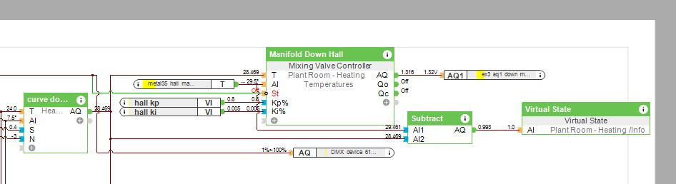

    you can make this a little easier by using the loggin in loxone config

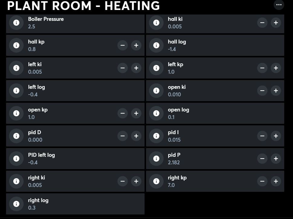

    create the virtual inputs to adjust Kp and Ki per manifold as above
    subtract the target from the measured temperature - this gives you overshoot and undershoot, and attach the result to a virtual state
    make sure the virtual inputs and virtual state are visible

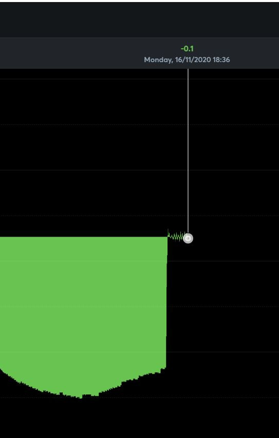

    set the update period for the mixing valve controller, temperature sensor and logging of virtual state are very short eg every minute
    on the attached log you can see the under-temperature (no heat demand, manifold cooling naturally, then a quick jump to the target temperature and very mild adjustments around the set point
    the results vary massively between manifolds - on mine the Kp vary between 0.8 and 7, the Ki between 0.005 and 0.015
