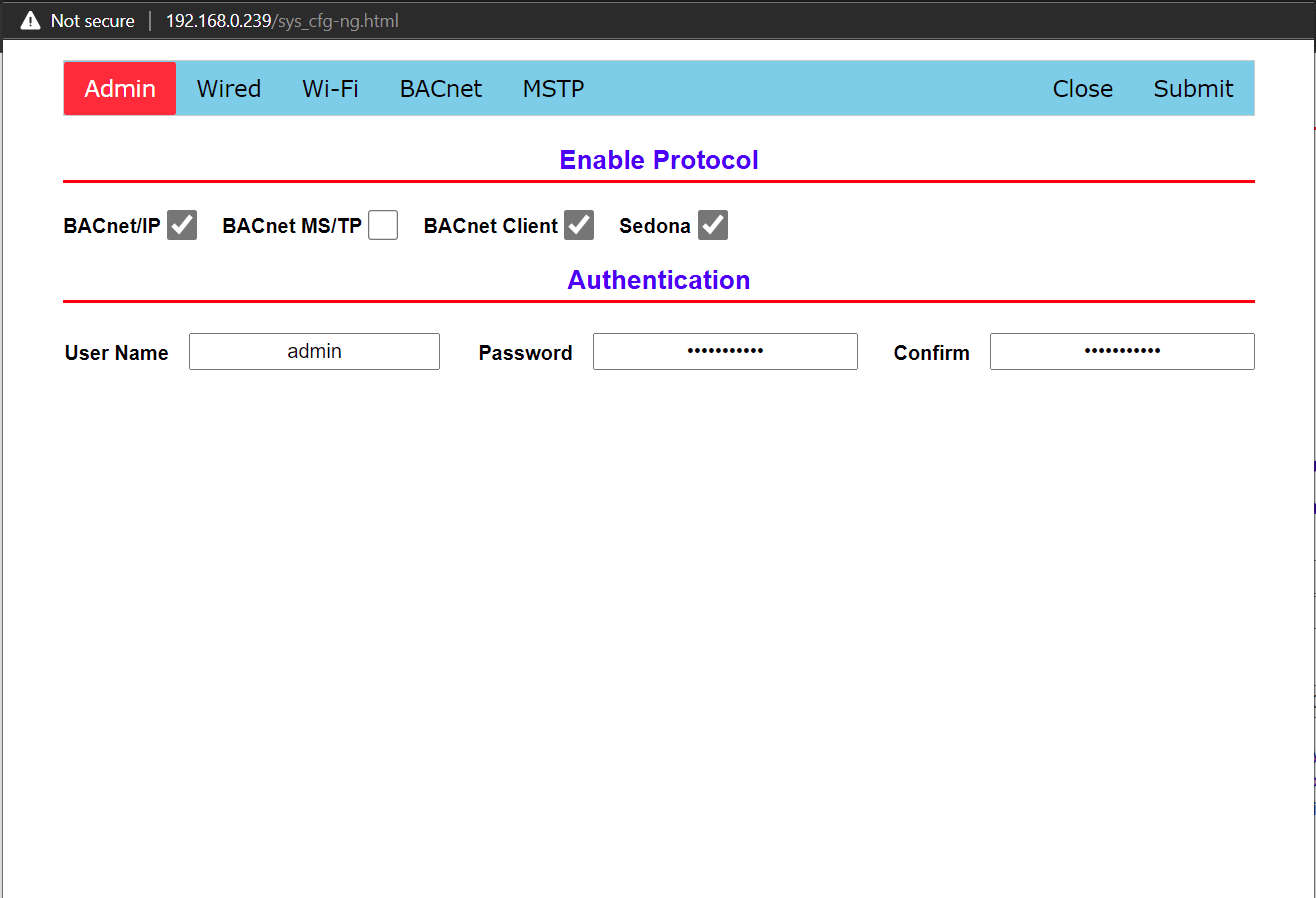

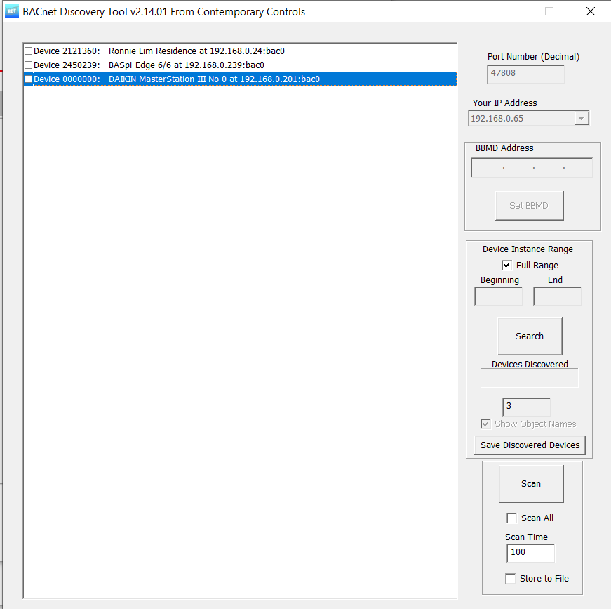

      Hi, I would like to ask some information on BacnetIP devices and configurations. I'm trying to integrate Daikin Bacnet with Loxone miniserver Gen 2 by using Baspi Edge 6/6. Since I'm not an expert on this part, I'm stuck in configuring this devices.
      I do understand that Miniserver act as Bacnet Server and in my case, Daikin Bacnet also is a server. I don't know how to configure inside Baspi Edge, plus the devices using Sedona Editor for programming.
      I know my information here is kinda haywire. I convey my apologies on that. Here I attached a picture from that controller. If somebody can elaborate or need more information, please let me know. I'm pleased to provide.
      Thanks Klicke auf die Grafik für eine vergrößerte Ansicht
