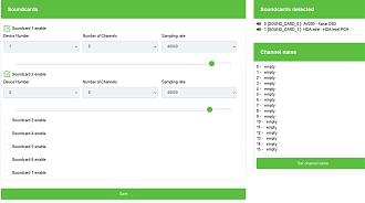

      Sounds ab bit like Alsa don't store the settings.
      Try at my test system, but work even after a reboot.

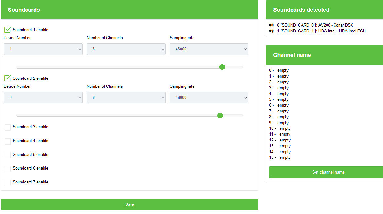

      Can you send me a Screenshot of the Soundcard Settings (WebUI) and without canging anything the output of the Termianl
      amixer -c 0
      amixer -c 1
      amixer -c 2

      screen shot of Soundcard Settings (WebUI) attached below main message
      Zuletzt geändert von digi77; 08.01.2023, 11:52.

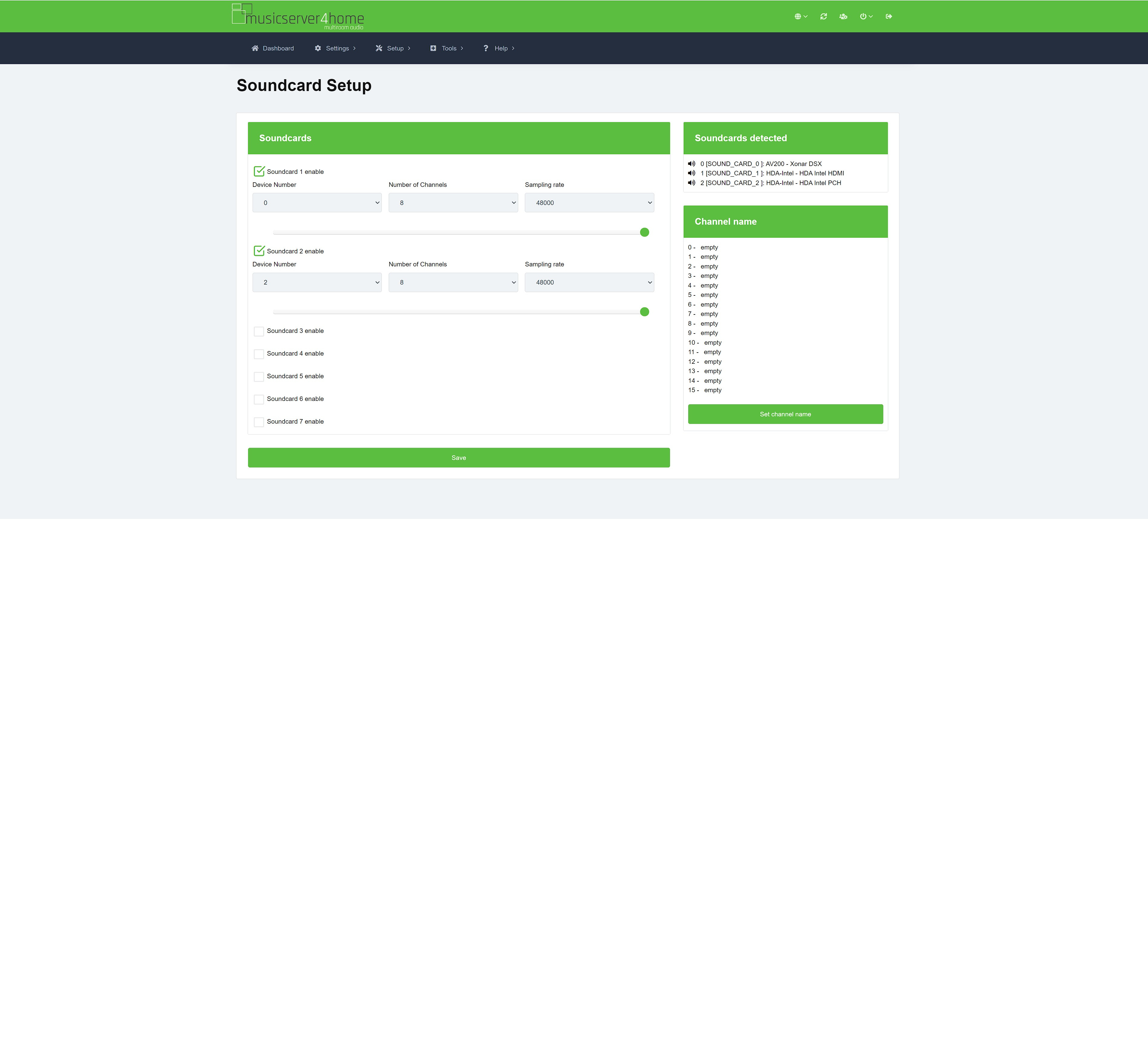

    Could'nt work out how to add photo in comments see attached screen shot
    Music server had been off a little while and started up quiet again, this is as per nothing touched.
    Zuletzt geändert von digi77; 08.01.2023, 11:51.
    • digi77
      digi77 kommentierte
      Did it again after 2hr off
      Ran your command and it goes to 100%
      Interesting, Alsa stores the Volume Values normally.
      Also what I don't understand is that it only loos the values for the Motherboard Soundcard and not for the Xonar.
      Will investigate.
      One additional question... Is still 100% in the WebUI fot the MD-Soundcard, or is there 69% ?

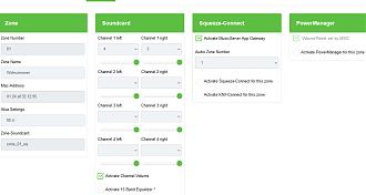

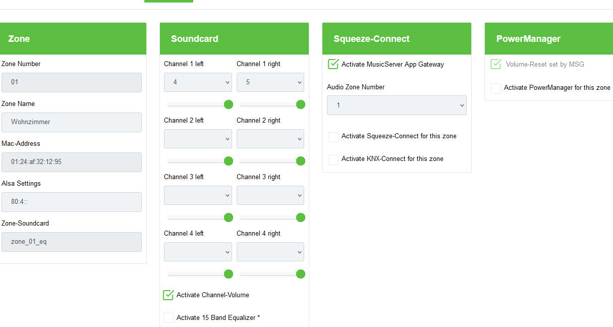

    Sorry for my late response, have had several things to do on the weekend...
    How can I help now?
    When I start any zone via app or via T5 touch the zone starts very quiet.
    I have set the volumes to 90% (as suggested in the manual)

    -have set the volume setting for each zone to 100%
    -"activate Channel-Volume"
Ansichten: 439
Größe: 133,5 KB
    When I now start playing music e.g. via T5 or via app it should get the volume settings from the MSG (if I am not wring) or if not, than it should start with the 100% pre-setting.
    In the loxconfig the start up volume "Vd" is set to 25 so it should be not too quite.
    with the original MuS it was much louder... now it is so quite, that you nearly do not hear that music is switched on.
    output from amixer:
    in next post
      simon_hh kommentierte
      Super...
      Es ist nicht so laut, wie beim originalen MuS (was eigentlich nicht sein kann), aber wesentlich besser... passe dem Wert Vd an und gut!
      Danke dir Dieter.
      Eigentlich kann es nicht sein, 100% sind bei Ubuntu und Debian Alsa 100%
      Ist nur die interne Soundkarte leiser oder beide?
      muss ich Ende der Woche nochmal schauen
