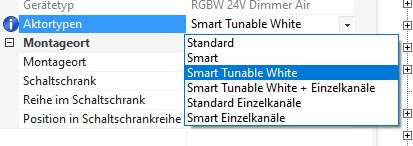

      • Pippo74
        Pippo74 kommentierte
        Trying it...
        1) If you've a full TW dimmer, Actuator type should be set to: "Smart Tunable White":
        TW1: Ch1 (WW) and Ch2 (CW)
        TW2: Ch3 (WW) and Ch4 (CW)
        2) If you're going to have just 1 TW, Actuator type should be set to: "Smart Tunable White + Single Channels":
        - Ch 1 (WW) and Ch2 (CW) are for TW
        - Ch 3, Ch 4 are for Single Smart channels.,
        Gast Bartnitzke
        @Florian
        Especially with case n.2, it's not really self-explaining; you need to respect RGBW dimmer wiring to have a correct handling of the TW channel.

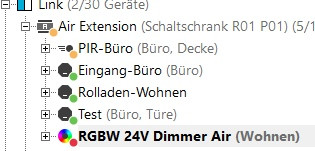

    • Andre2
      • 21.06.2022
      • 47
      VERY INTERESING Pippo74.
      Where do I find what you explained above ?​
      I assume in the "RBG Lighting Controller"
Ansichten: 480
Größe: 52,7 KB
      but no such settings herein.
      My Loxone Config is 13.0.7.26​​
      I'm a total novice with LOXONE. This is the first time ever that I try to control LED lamps with an RGBW 24 Dimmer ​
      So my question potentially is stupid ...
      I screenshot would help (and be appreciated of couse) to copy / understand what you have programmed to control 2 tunable with LED Strips.

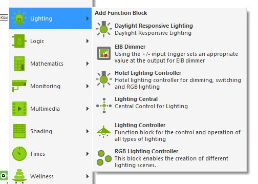

      • Pippo74
        Please use the Lighting controller.
    • Andre2
      • 21.06.2022
      • 47
      ... I found it
Ansichten: 382
Größe: 20,9 KB
Ansichten: 389
Größe: 28,8 KB
      Next step get the LEDs to light somehow .. which is challenging for a beginner. I will make it somehow .
