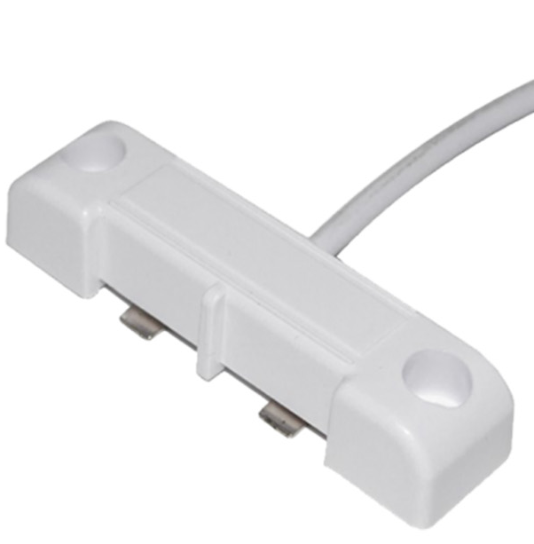

    As the 'Loxone Water Sensor Air' gets broken when it's submerged into water...
    I'm searching for alternatives for the classic wired water sensor which is discontinued by Loxone.

    looks like this is the one from loxone
    • querex
      • 14.07.2020
      • 177
      Thanks, indeed, looks the same and the price is OK.
      Just thinking, could it be an issue that the 24v is connected with the water when for example the basement is flooded?
      I guess the 24V could be an issue?
      But when another device (for example 230V) shorts on the water of the flooded basement, the 24V will raise to 230V (for a very short time), which can cause damage to the 24V loxone installation?
      Any advice or alternatives? All feedback is welcome!

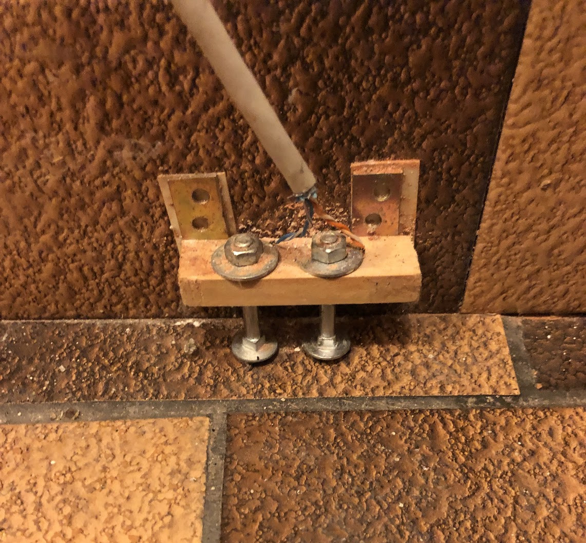

      Since years I use the Kemo Waterswitch (https://www.conrad.at/de/p/kemo-m158...BoCPe8QAvD_BwE) in my boiler room, and already had several real alarms.
      It has a relay, but is powered by 12VDC.
      The box is mounted 2 meter high, and the electrodes are shown in the picture
      Possibly nothing to install on a visible place, but works as expected.
