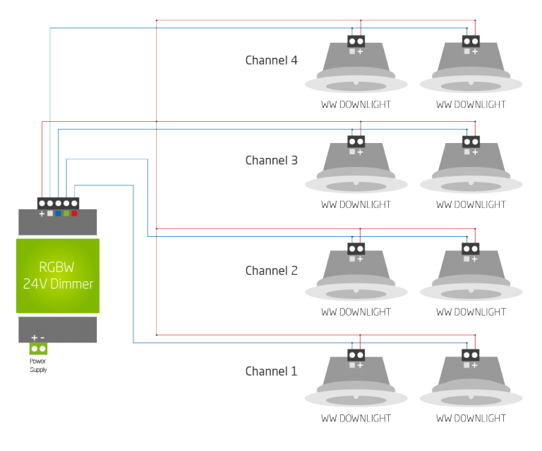

    Hello, i need to control 4 differents canal with 6 mini spotlights 3v 2w 700ma per canal. So i think i need to put a dimmer bettween the extension and the lights.
    Do you already make this kind of install ? if yes which kind of driver did you used ? thanks
    Click image for larger version  Name:	EN_KB_Diagram_ww_Spot.png-768x640.png Views:	0 Size:	194.3 KB ID:	281645

    What exactly does this mean:
    6 3v 2w 700ma
    If you have constant current (CC) spots, the Loxone RGBW Dimmer will not work.

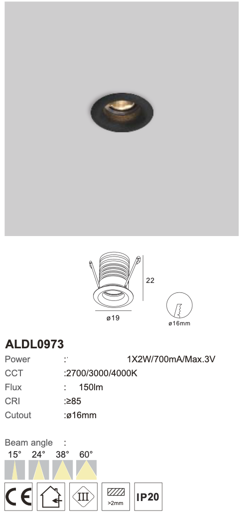

      here the spotlight datasheet, didn't choose the drivers for the moment so i can choose CC or voltage drivers. but i need an advice to choose them ;-)

          This is a CC spot, therefore you require a 700mA CC driver. You cannot dim this with Loxones RGBW Dimmer.
          You may find a CC dimmer for the DMX bus, or a CC driver that is dimmable via 0-10V. Or, if not bought yet, select another spot with constant voltage.

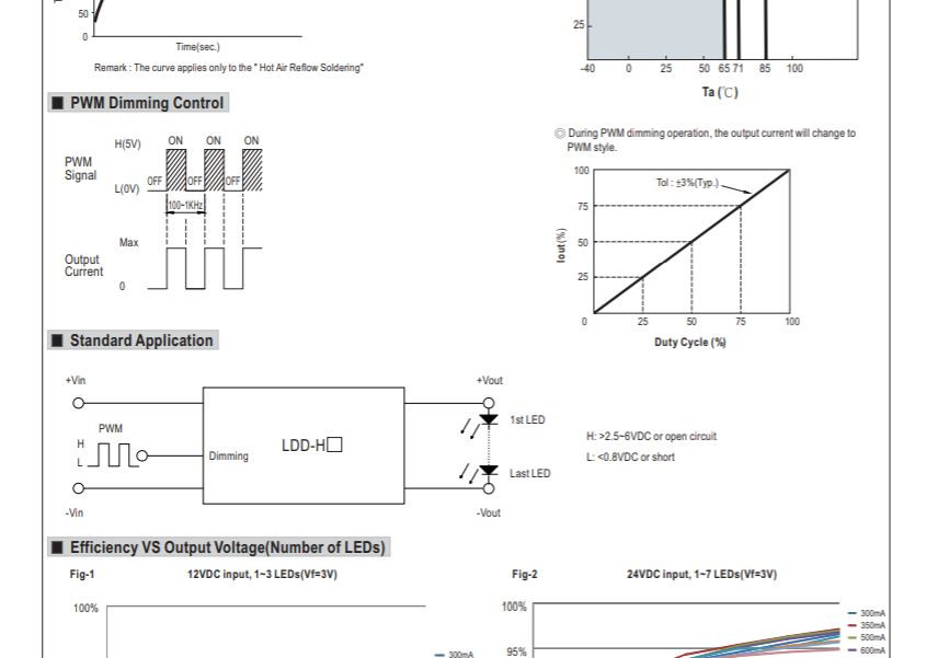

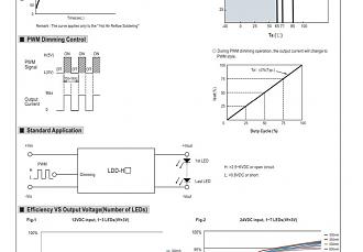

            hello Chistian,
            this driver accept dimming with PWM so do you think we could control it with RGBW dimmer ?
            Mean Well LDD-700HW DC-DC Step down LED driver Constant Current (CC); Input 9-56Vdc; Output 0.7A at 2-52Vdc; Wired input and output; Dimming with PWM and remote ON/OFF
            • duncan
              • 320
              the meanwell drivers need a +v, 0v and pwm signal, you cant use pwm signal on the +v supply unlike a normal CV led strip
              the pwm signal could come from the loxone dimmer in theory, but it needs 5v pwm signal and i dont think the loxone pwm dimmer will work at 5v supply
