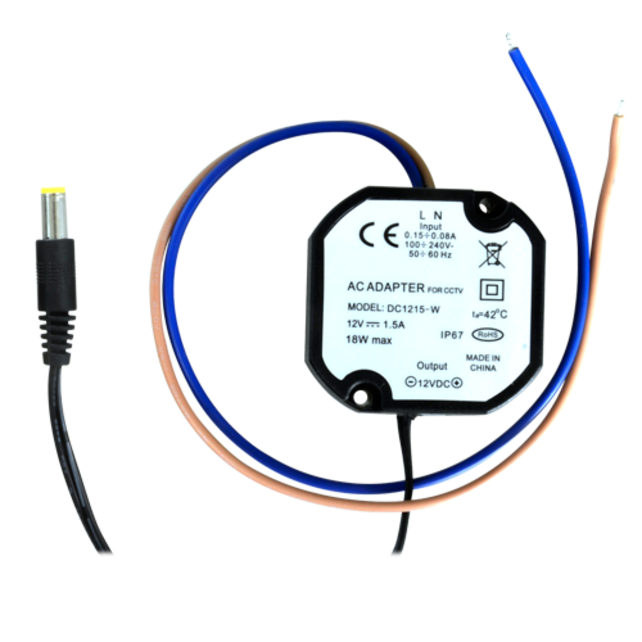

Bye the way, there are small powersupply's that will fit into a wall box, behind a switch or socket. Just in case you need a small powersupply.
Something like this:
