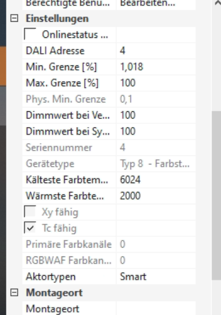

    Labmaster I currently use 5 TW - Benory Spots (10W) in a 9qm bath, but for me it seems the produce too less brightness. Do you have any hint?
    Benory TW - 24V 10W 2000K-6000K 60° MR16 Spot Black -Lunatone DALI DT8 CW-WW LED Dimmer 16A Din Rail - 100W /24V Powersupply from Loxone (LOX-100-24-1 Output: 24VDC 100W)
    Is there any configuration which still can be done? Or is the power supply wrong?
      • 2585
      Don''t know,
      is the DALI Dimmer configured to allow full brightness ? (i don't know this specific Dimmer, but the PWM range might be possible to be adjusted )
      I have 4 x 8W TW Spots in a 7qm bathroom, they are bright enough

        Hello,
        I got these settings from Loxone:
Name: Bildschirm­foto 2025-02-05 um 09.05.44.png
Ansichten: 82
Größe: 141,3 KB
