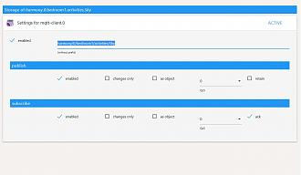

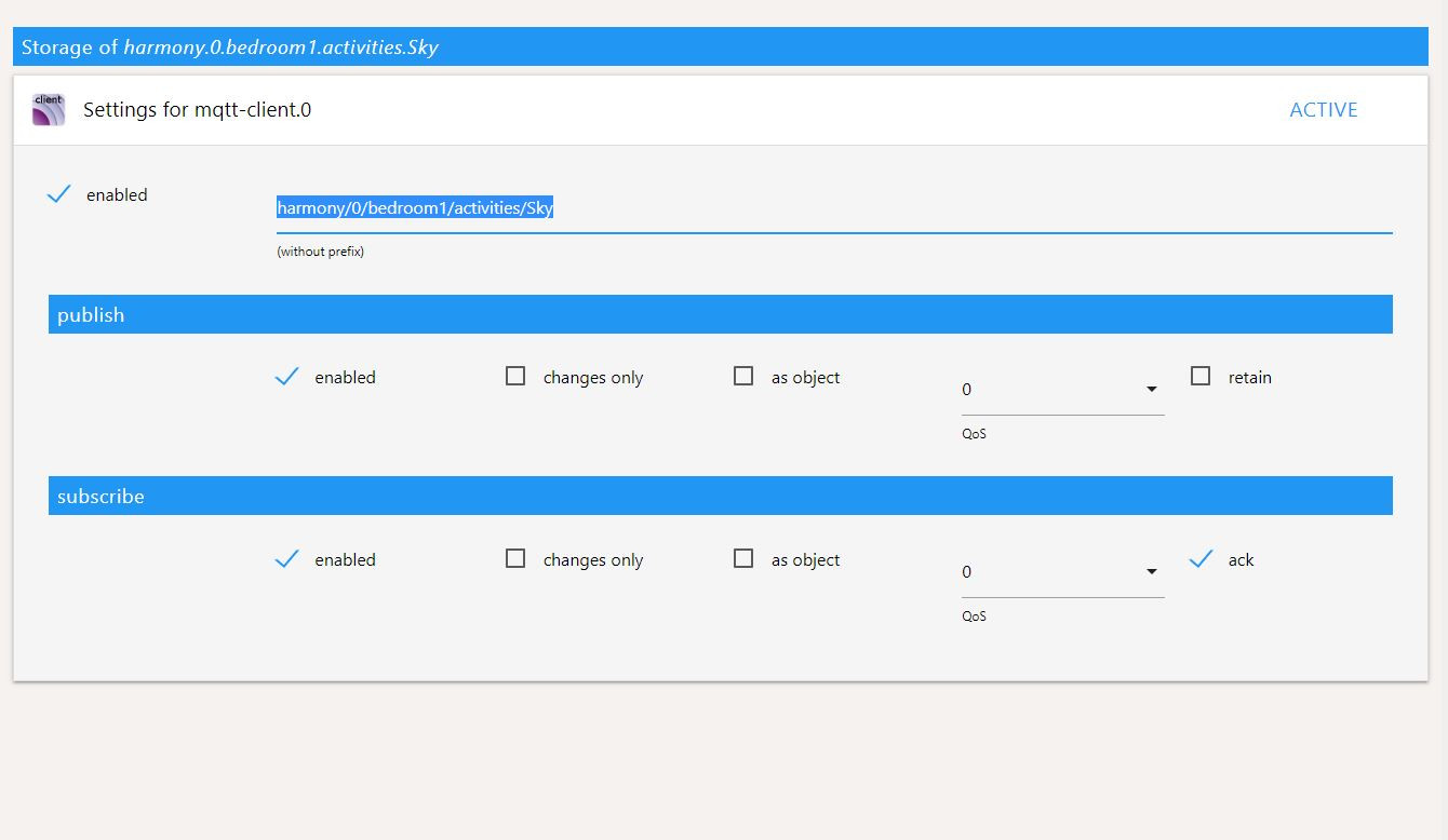

          a further question:
          ive got this all working thanks to your help and decided to see if i can control the harmony hub using mqtt instead of the simple API

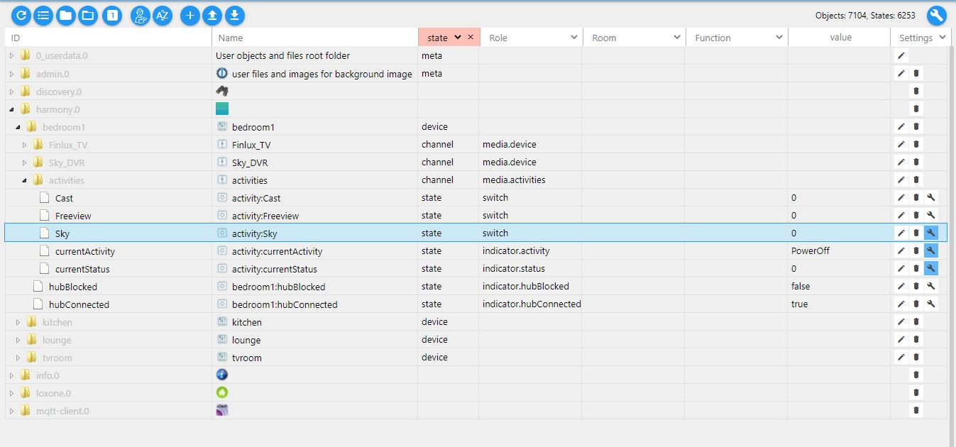

          in iobroker ive enabled mqtt on the harmony functions eg 'Sky' for subcribe and publish
          i can read the state of the harmony activity in the loxberry mqtt - i can see
          iobroker/harmony/0/bedroom1/activities/Sky is visible as harmony_0_bedroom1_activities_Sky with its number eg 0 for off, 2 when on
          now if i modify the mqtt from loxone using a virtual output to the loxberry using udp i can change
          harmony_0_bedroom1_activities_Sky 0 to harmony_0_bedroom1_activities_Sky 1 but the harmony iobroker entry doesnt change and the harmony doesnt turn on
          any ideas why loxone can change the mqtt broker but the mqtt broker doesnt modify the iobroker/harmony hub?
          my iobroker mqtt settings are:

            First you should always remember to uncheck "ack" flag on subscribe settings (this is based on my experience with ioBroker MQTT).
            Second: remember to reset this topic to 0 again (from Loxone) as this should be a pulse not a state.
            Haven't tried but should work fine.
