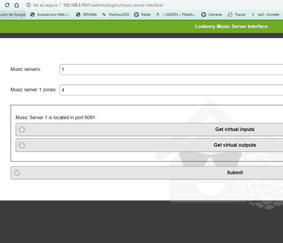

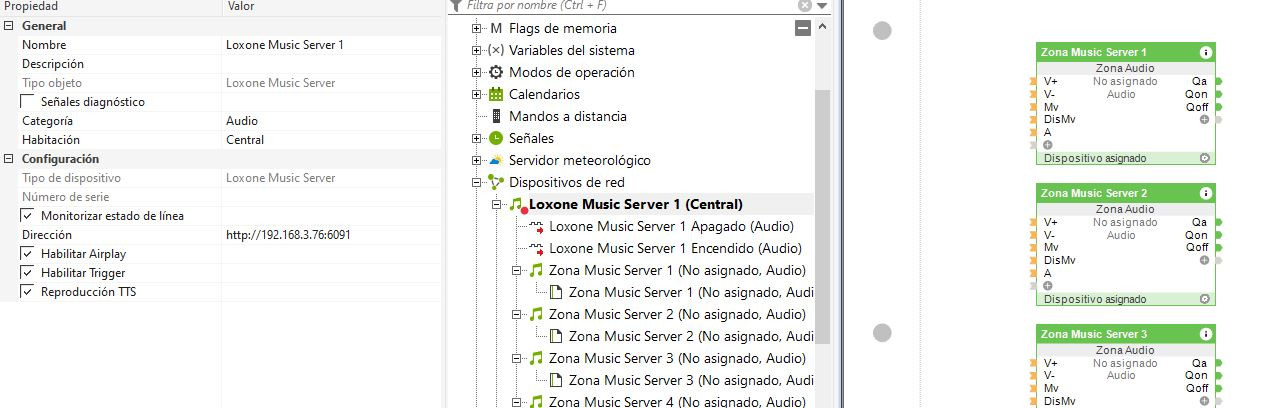

            • jviheavy
              • 19.08.2019
              • 22
              Mine is in red
              In Loxberry:
              Install repository
              Restart Loxberry
              Set the number of zones to 4 (I don't know why another line appears with another music server)
              Restart Loxberry
              In Loxone Config:
              Configure MS http://192.168.3.76:6091
              Take zones to a page
              Load the MS configuration
              I try to restart the Loxberry or the MS but it does not work
              It seems very simple, but I don't understand why it doesn't work
              Does it have to have any services lactive SSDP?
              Best regards
              P.D.:
              Pictures attached
              Loxberry Current Version: 2.0.1.3
              Music Server Interface Version 1.0.1 (But I install the link from the wiki 2.0)
              Zuletzt geändert von jviheavy; 16.04.2020, 07:44.

                When enter in http://192.168.3.76:6091/audio/cfg/all nothing happens...No results...no 404...the website doesn't exist
                I installed another Music Server from Loxone...and works fine
                Now I'm trying to enter in the by Configuration way but doen't works...Directly from the Loxone config neither...
                My Loxone version is 10.3.11.25
                That is weird. It looks like other plugin daemon is preventing starting this one. Which other plugins do you have installed?
              • jviheavy
                jviheavy kommentierte
                Thanks
                With SSH and this command: ~/bin/plugins/music-server-interface/index.sh
                Works perfect
              I just published 1.2.0 that contains a fix for shuffle (I'm not sure what I was thinking on when I programmed that part 😅), implemented repeat support (no repeat, single track repeat, full playlist repeat), and added some fake responses to some additional sections to avoid spinners being shown. My next focus will be to implement IP coding in the LoxBerry interface to decide where to send UDP messages.
