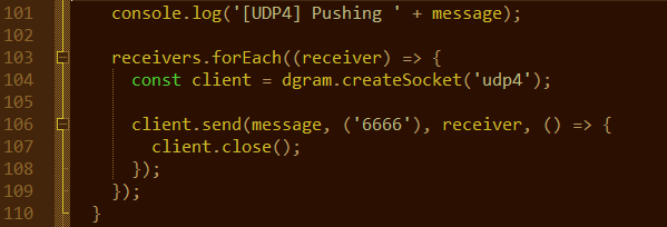

    hismastersvoice Sounds good. Setting the number manually is the best way from my point of view. Everything else will be confusing. So in the "Music Server Interface Plugin"-Config you just have to set the IP of the Gateway?
      The IP an hopefully in the next version also the port.
      I just created this commit https://github.com/mjesun/loxberry-m...e5b2fa5b1adbf8, which sets the outport to 6091, and the inport to 7091. So:
      * Miniserver-> Music Server uses 6091 TCP
      * Miniserver -> plugin uses 6091 UDP, and
      * plugin -> Miniserver uses 7091 UDP
      In addition, you can also configure a custom IPort pair on the extra field. Would that cover all use cases?

          #51
          Gast
          Don´t work with IP:UDP-PORT
          If I put an fixed Port into it I get the msg, if I configure it in the UI it don´t work.

          *plugin -> Miniserver uses 7091 UDP*
          MiniServer get still at 6091 msg back
          Also the VI Template creates still 6091
            Oh that's not released yet, I just put it in a separate branch. Will try quickly building a ZIP.
