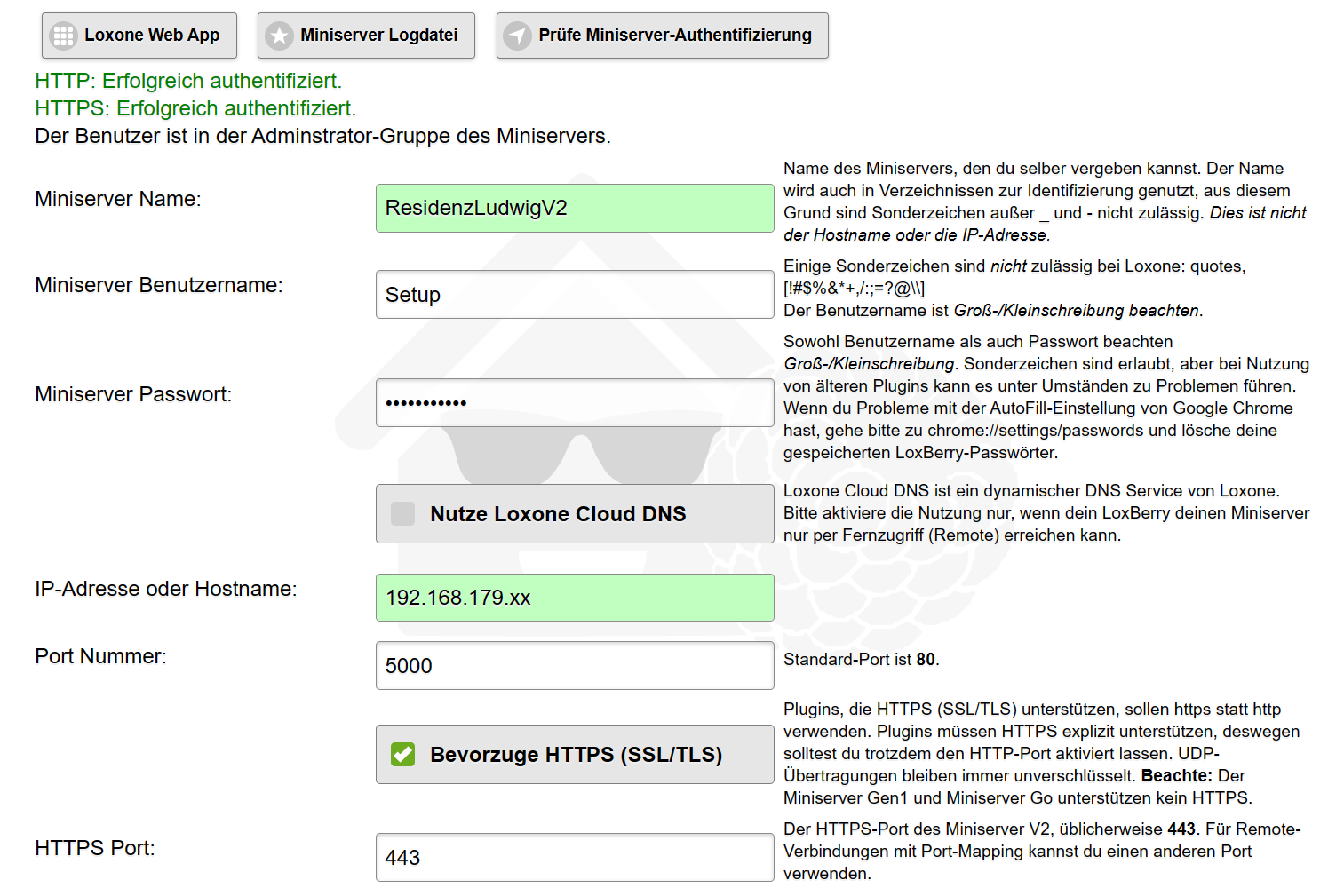

        ​Hi Nufke,
        I have looked at it, the config file looks ok, both miniserver are entered correctly.
            "miniserver": {
                "1": {
                    "mqtt_topic_ms": "lox2mqttms1",
                    "publish_structure": false,
                    "publish_states": true,
                    "subscribe": true,
                    "mqtt_topic_app": "loxberry/app",
                    "icon_path": "/assets/icons/svg"
                "2": {
                    "mqtt_topic_ms": "lox2mqttms2",
                    "subscribe": true,
        At the bottom of the page is displayed in green that your plugin is running with the corresponding PID.
        What comes to my mind, my miniserver is not reachable under the standard port 80, but another port was used, but this is entered correctly on the configuration page in the Loxberry and on the page the connection is tested successfully.
Name: Screenshot 2023-05-11 223807.png
Ansichten: 1240
Größe: 342,8 KB
        What do you need to connect to the miniserver?
        Greetings Sascha
        Zuletzt geändert von Meininger; 11.05.2023, 21:42.

          Implemented support of Miniserver ports other than 80 in version 0.2.3. Please check

              Ok let's explore further... Can you check the following with 0.2.3:
              • Do you see the other log entries like log started, register, etc?
              • the plugin should not restart after exiting, so the PID should become red/unknown and no reoccuring entries in the log file.
              • Is the correct port number listed in the log? Since you use HTTPS, it should state 443 (from your general config)
              I expect the issue relates to the connection to Miniserver HTTPS port, so I will study this further. Unfortuantely I have no V2 Miniserver so I cannot test HTTPS. If possible for you, you could test with HTTP port 80 (or 5000 in your case), so we can confirm it relates to the port setting.

                  Thanks for the feedback. The plugin does not monitor yet if there are changes made to the general miniserver settings. I will add this to my list. For now, just hit the save button in the plugin config page.

                      Can you check the value of the miniserver field "Preferhttps" in your general.json file? In my case it states "null" since it is disabled, because I have a Gen1 Miniserver. I expect you have something like "false" (as string with quotes). Can you confirm?
                      I also noticed I used the old and wrong authentication method, which was still working for my Gen1 Miniserver but most likely not for Gen2. The plugin now it uses the recommended token-based approach. This might explain the issue with connecting to your Miniservers.
                      I uploaded v0.2.4. Since I did not implement detection of the general.json changes, after changing the Miniserver settings, restart the plugin by doing a save/apply in the plugin config window. Just try this one and report your findings

                        First, with the new version of the plugin it also works for me, both miniserver are connected and deliver data. It does not matter whether HTTP or HTTPS is selected or not. Your plugin always connects via HTTP to the miniserver.
                        Here is the excerpt from the​ general.json:
                        "Port": "5000",
                        "Porthttps": "443",
                        "Preferhttps": "1",
                        "Securegateway": "",
                        "Transport": "https",
                        "Useclouddns": "0"​
                        I hope that this could all help a bit further.

                          Great to hear it is working now. In v0.2.4 I check if Preferhttps is "true", but based on your info I see it uses "1" instead. I will update this in the next release later today or tomorrow, then you could also check https.
