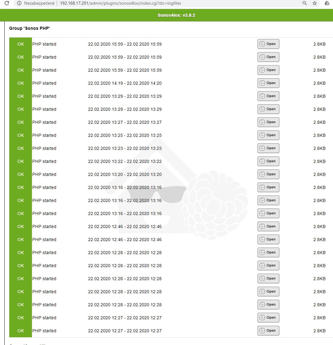

    Hi guys, sorry for english
    I have My LoxBerry v1.4.0.3 and Sonos4lox: v3.8.2
    All was working well and It stoped working T2S.

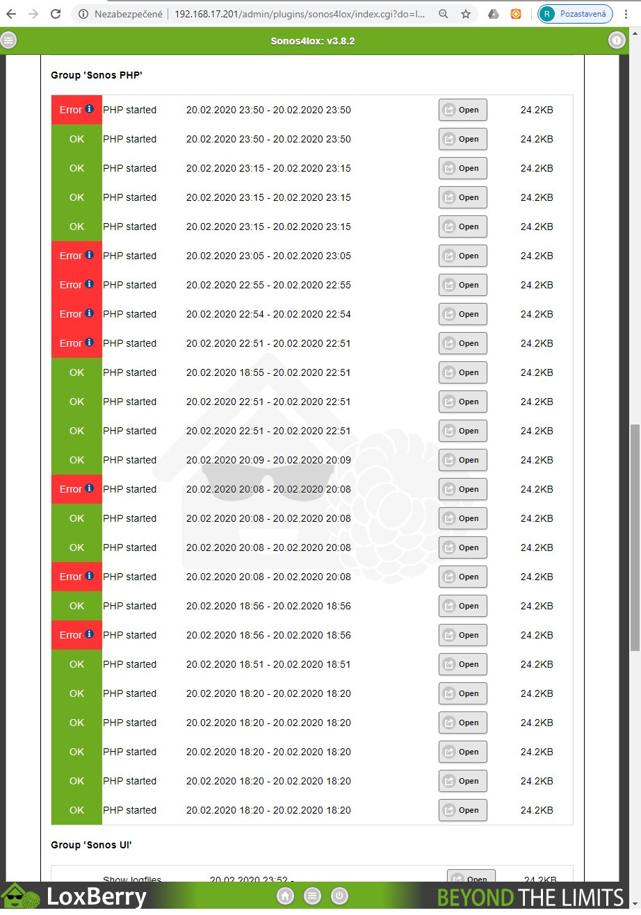

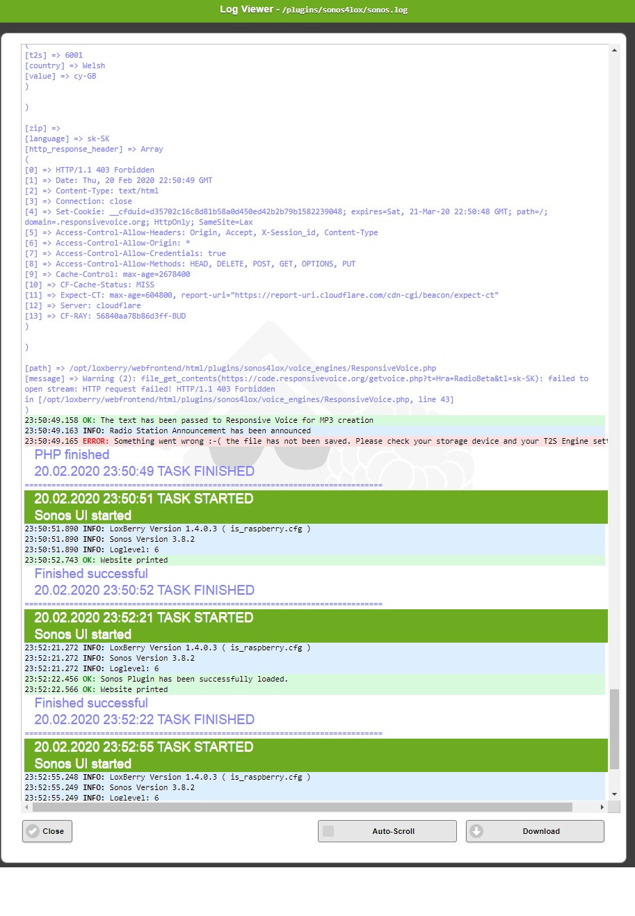

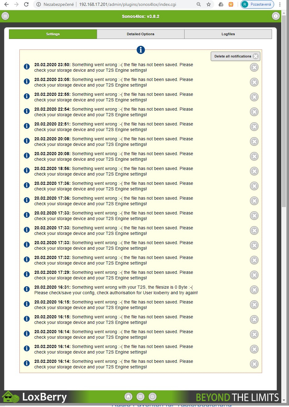

    I have always this notification:
    20.02.2020 23:05: Something went wrong :-( the file has not been saved. Please check your storage device and your T2S Engine settings!
    See all details in attachment.
    Can you please help me ?
    Many many thanks for each help

      Stated on the page before(but in German):
      RespVoice changed their API, you need to switch the engine.
      Clear the cache after switching.

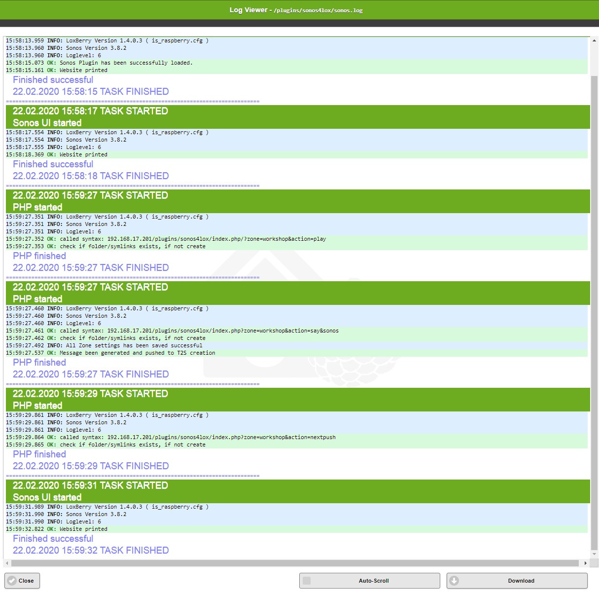

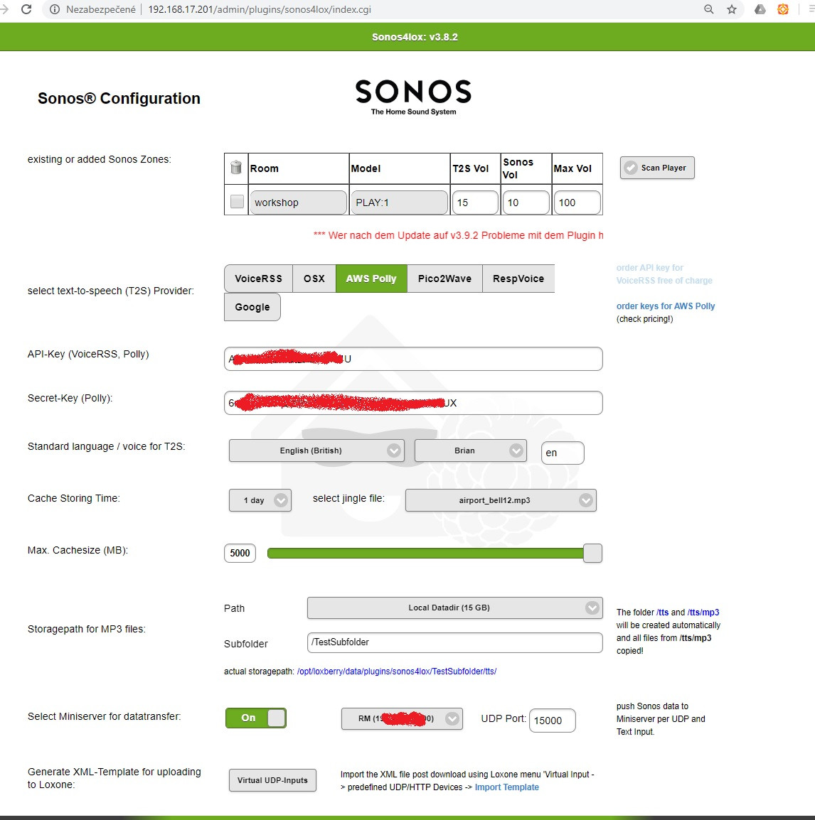

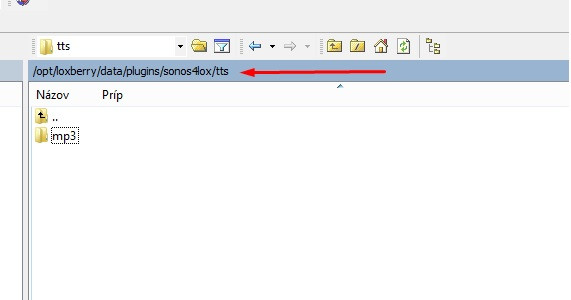

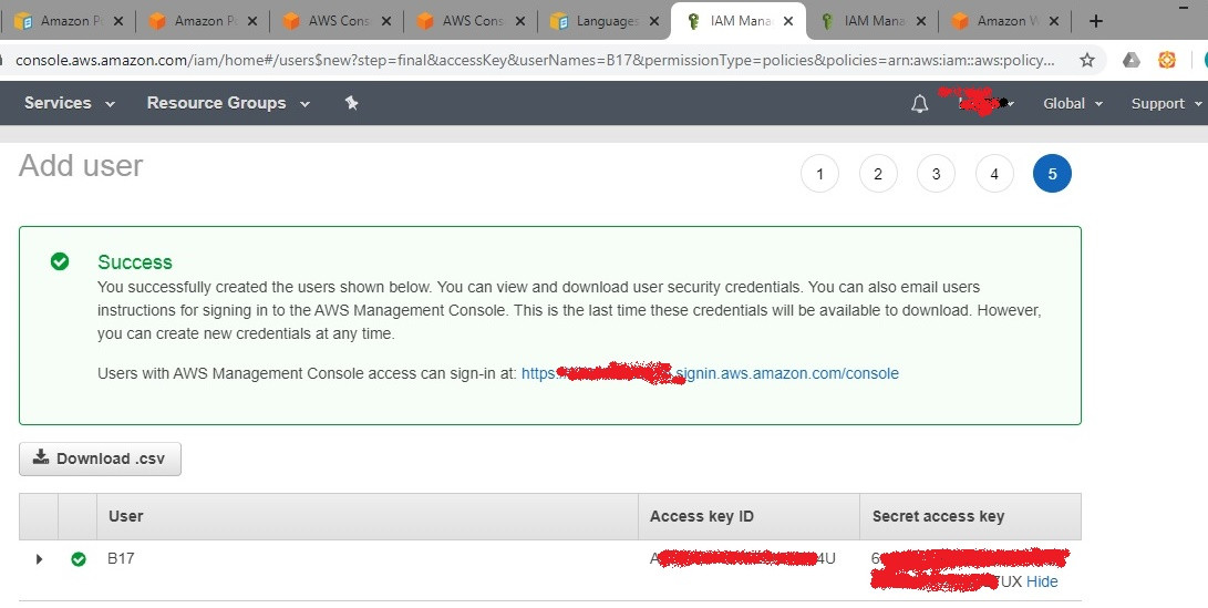

                Hi guys I am posting in new post due to attached pictures. sorry for english
                I have used RespVoice engine but due to api change based on your info I have created account in AWS polly and there created user as you can see in attachment to generate APi and secret key I suppose I did it correct.
                Then I add to loxberry and save and now I have no error in logs but it is not generating T2S mp3 files. I have no file in folder:
                /opt/loxberry/data/plugins/sonos4lox/tts
                I have no idea why it is not generating any files?
                Can you please help me where is the problem ?
                All details you can see in attachment. Many thanks
                  • 6310
                  #999
                  What about your /TestSubfolder setting in your plugin settings?

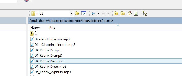

                    #1000
                    Uff sorry I have uploaded wrong picture of folder.
                    here you can see that testfolder and also tts is clear. I have only saved some mp3 files in mp3 folder as you can see in attached pictures
