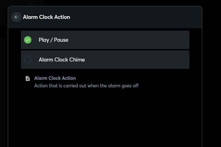

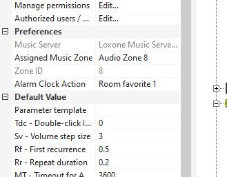

                its not strictly a release question, but something i noticed installing the release and using the musicserver gateway
                when you add a music zone, there is an option to select the Alarm Clock Action, including play/pause and the choice of room favourite 1 to 8
                in the loxone app gui, you can adjust this but only in expert settings , beteen play/pause and alarm clock chime, but an end user cant select which room favourite plays when the alarm clock goes off
                have i missed something or is it a bug? problem with the gateway?
                • hme0354
                  hme0354 kommentierte
                  not every feature of the loxone musicserver works on on the msg or ms4h
                  Perfectly explained...
                  In the future there will be more functions in the MSG, but know there are only the basics
