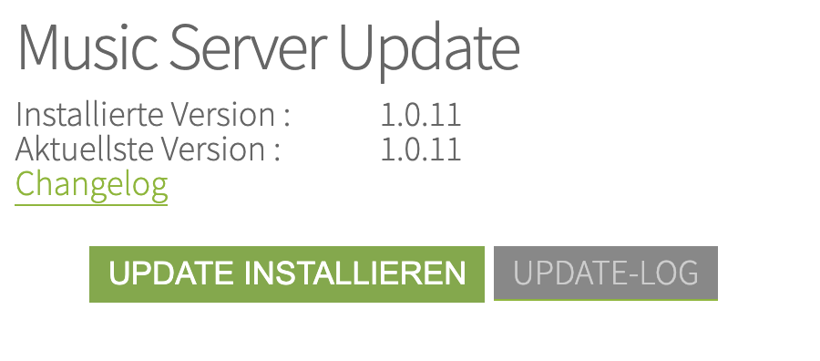

So I hit the update button and it says 1.0.11 installed on the update page even though the update window never quite progressed. Then I check the support data and it says I have Ubuntu installed and version 0.6.2 installed.
I don't, I have Debian installed and at least 0.7.4.
No change in the look of the interface or the name - so it is definitely not 1.0.11.
I see at at support data that you use Ubuntu not Debian.
If the Script see that your use Ubuntu the skript stops.
There is a issue that the version is set to 1.0.11, this I have to fix.
The support data is read out direct from the system files of the os, so I can't believe that it says ubuntu when your on Debian.
