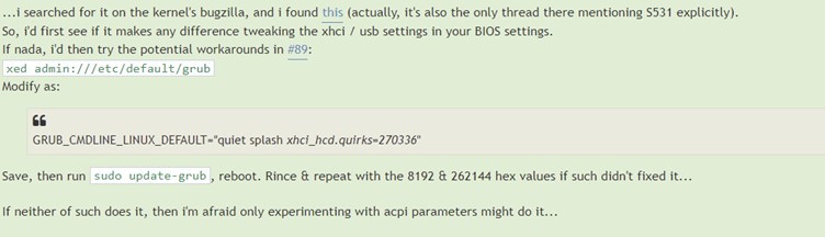

    there is an issue with linux that certain intel computers will only restart rather than reboot - this makes it impossible to use the power off feature of ms4h to save power
    the issue is relating to a bug in the usb3 driver and only shows up when you enable WOL
    the fix requires either to disable usb3 contollers (no good for us with usb sound cards) or a moderate amount of linux ability to update the grub settings

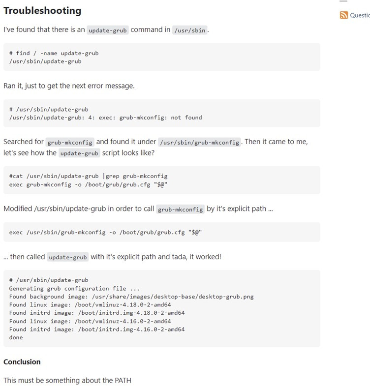

    unfortunately there is also an issue where the utility to update grub also doesnt work without a fix....
    the reboot fix:
    sudo editor /etc/default/grub, GRUB_CMDLINE_LINUX_DEFAULT="quiet splash xhci_hcd.quirks=270336"
    then run sudo update-grub, reboot
    if this doesnt work then try 8192 or 262144 instead of 270336
    if update-grub doesnt work, its to do with su, sudo and path
    issues and fix show in attached images
