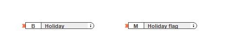

    Is there any way to have a signal (digital wire) linked to particular operating mode? Something like memory flag but linked to for example Holiday operating mode.
    The operating modes are good but only work for certain blocks. Sometimes I need to wire more complicated logic.

    as far as i can see, just drag the operating mode onto a room page and attach it to a memory flag - the flag goes positive when the mode is active
    that seems to work when i test it
      Thanks. How did you connect both? When I drag operating mode to a page then it acts like an output. For example to activate the mode.
      • duncan
        • 313
        in order to activate an operating mode you drag it onto a page (as an output) and connect some kind of function to it like a switch or timer
        drag a second copy of the mode onto a page and it acts like an output
