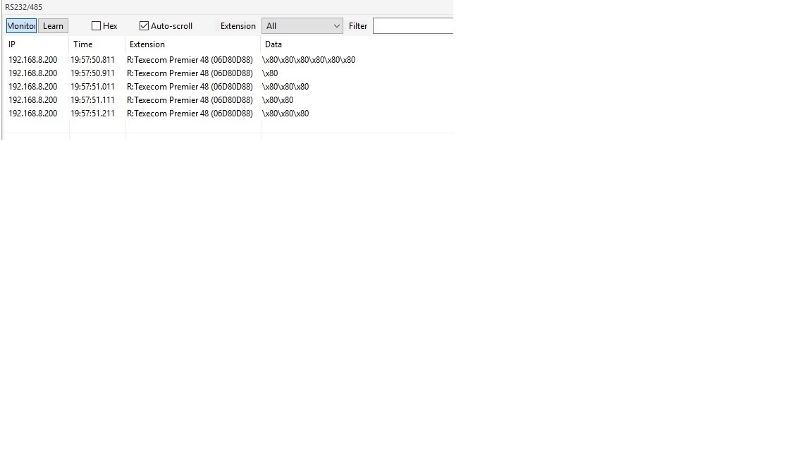

          Hello Gary,
          I am busy with the same project, I am using the Texecom Premier Elite 64W panel, but I cannot get the RS232 monitor to display clear text, I've read a few articles and I should be receiving clear text. Were you ever able to arm and disarm from Loxone?
          Sincerely Klicke auf die Grafik für eine vergrößerte Ansicht
Ansichten: 1298
Größe: 118,7 KB
            You serial interface parameters appear to be correct. Check your cable / connections.
            • richard@ihome.solutions
              • 03.03.2019
              • 3
              Hello, the problem was I needed a TTL driver on the wire between the panel and the RS232 extension. Has been working well for many months, have done some commercial deployments.
