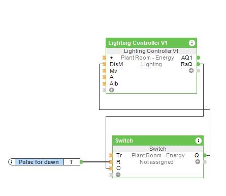

    Who can help me or show me the way to get this:
    In bedroom (kid 1, kid 2, parents), I have motion sensors which put on the light if insufficient lux. I don't want this during the night off course, so I want to disable the motion sensor to put lights on.
    I think a solution to activate the scene "goodnight" is the solution, but don't know how to implement this.
    So basically I think something like this could be a solution:
    * triple click on touch activates "goodnight kid 1"
    * goodnight kid 1 disables the motion sensor to put light on
    Can anyone help me out?
    thanks,
    Tomr

      just use the DisM input of the light block to disable the motion detector - connect this from your Good Night signal which can be whatever type of input you want - it could be triggered from a timer, a physical swtich, a virtual switch or a triple click pulse from a lighting controller
      in the example ive posted ive used your triple click to block the movement sensor, and it auto resets at dawn
        Thanks for the help, this solves my challenge. Up to the next one :-)
