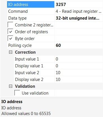

    I'm struggling with polling some data from my Schneider Smartlink system. I currently poll voltage and current data in float32 datatype. But the total energy is int64 datatype.
    I try to set up 4x int16 registers and combine the results via a formula, but none of the registers are getting data. This solution is working just fine with openhab2 system, but not on the loxone :S
    Anyone have an idea of a solution?

      Thanks for your reply Tico!
      I have already tried this, And just can't figure out why I don't recieve any data! :/
      See attachment..
      Found this formula, for combining 4x 16-bit registers:

        Thanks for the formula. I'm sure you've tried multiple combinations, but the attached is what worked for mine (albeit just the first 32bits). This also converts Wh to kWh to avoid using a formula block (using Correction 1000 to 1).
        Have you tried address 3256 and 3258 just to check where the modbus offset might be? Also un-check 'Byte order' and try with a check against 'Combine 2 registers'.
        Zuletzt geändert von Tico; 28.08.2018, 04:56.
