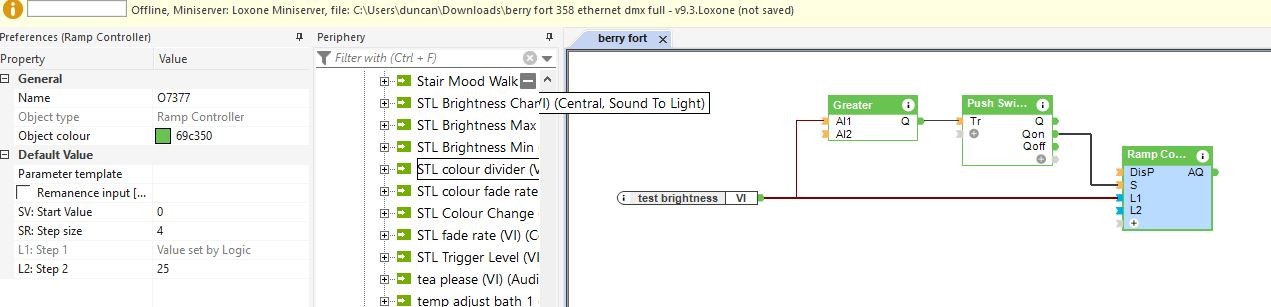

1) change the bulbs to ones that start or dim lower - are they gu10 retrofit or integrated led downlights?
2) use a different dimmer - eg the knx theben fix2 has a setting for leds that starts slightly brighter and quckly dims down to the set values precisely to fix your problem
3) configure some loxone logic to start at a higher level and ramp down to the set one -- a ramp function can be made to do this
