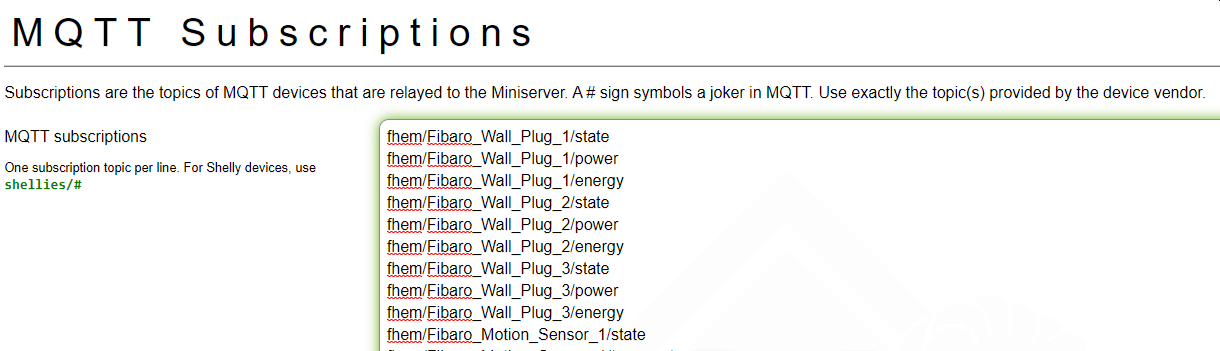

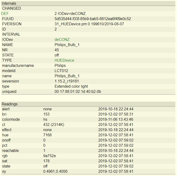

      Hi @bauwt,
      I will describe it for you briefly in points.
      First, Fibaro Wall Plug loopback:

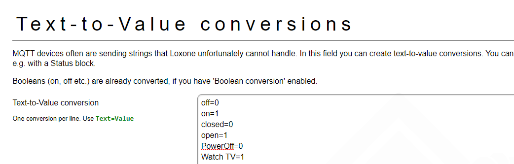

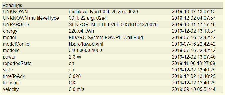

      1. I'm using FHEM Plugin to manage my Z-wave devices. FHEM has all current readings of wall plug, including "state" (see attachment 1)
      2. I'm using MQTT-Gateway plugin, that includes Mosquito MQTT broker and an engine for pushing new MQTT readings to Loxone Miniserver over UDP or HTTP. I'm using UDP.
      3. In FHEM I could publish only wall plug state to MQTT, but as I have multiple different devices in FHEM with different readings I'm interested in, it's more convenient for me to push ALL FHEM readings to MQTT. For command set to push all FHEM reading to MQTT see attachment 2
      4. So now I have MQTT topic fhem/Fibaro_Wall_Plug_1/state with value on or off depending on real state of the wall plug.

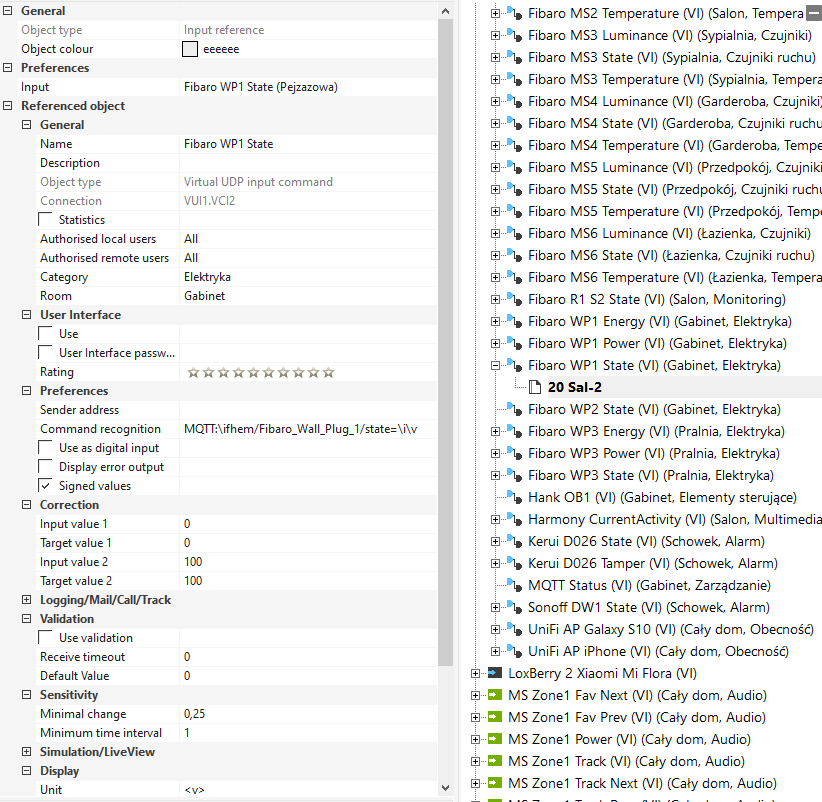

      5. To have it sent to Loxone I need: a) subscribe that topic in MQTT-Gateway plugin and b) convert "off" to value 0 and "on" to value 1, as I'm using UDP. See attachments 3 and 4 for that.

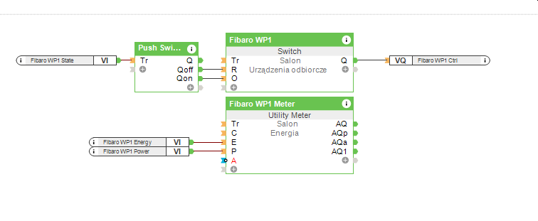

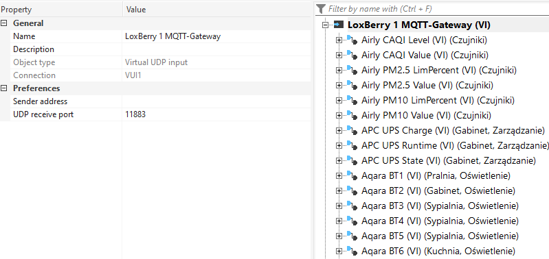

      6. Now I just need to add Virtual Input in Loxone Config. See attachment 5 and 6 for that.
      7. I've used a simple Switch block in Loxone Config that has a Virtual Output connected to control the wall plug (http call to FHEM "/fhem?cmd=set%20Fibaro_Wall_Plug_1%20on" and "...off"). The point is, it also has external input control. See attachment 7. Please note: Push switch block is used here solely to detect edge (it's not used in Visualization!). Since new Loxone Config version >10.3 you've better use new "Edge detection" block instead.
      Easy!
      So you may do exactly the same with Hue Lights.
      1. Install FHEM Plugin in your LoxBerry.
      2. Connect FHEM to HUEBridge with included Hue module. Command set starts with something like define MyBridge HUEBridge HUEbrideIP:HuePort. Read FHEM HUE-module docs for details how to connect it.
      3. After you sync lights from HUE Bridge to FHEM, you will be getting all reading for every Light. See Attachment 8 for readings of one of my Philips bulbs.
      4. Since I push all readings to MQTT, I would have that bulb state under something like fhem/Philips_Bulb_1/state
      5. Then I would subscribe to that topic in MQTT Gateway plugin and push it to Loxone.
      6. Finally, I would create Virtual Input with Philips Bulb 1 state in Loxone Config.
      7. Then you might use Edge detection block out of its input and connect it to O and R inputs of Lighting Controller block.
      8. If you had more than one bulbs/lights used on that Lighting Controller, that's another challenge, but I suppose it is out of the scope of this topic.
      9. A different challenge is to sync back more than just a state (on or off). Think of ct / bri / rgb readings for a full blown RGB(W) bulb. But I suppose it's also possible.
      You will probably figure out all details on your own, if not - just ask me for details on the very specific points of this mini-howto
