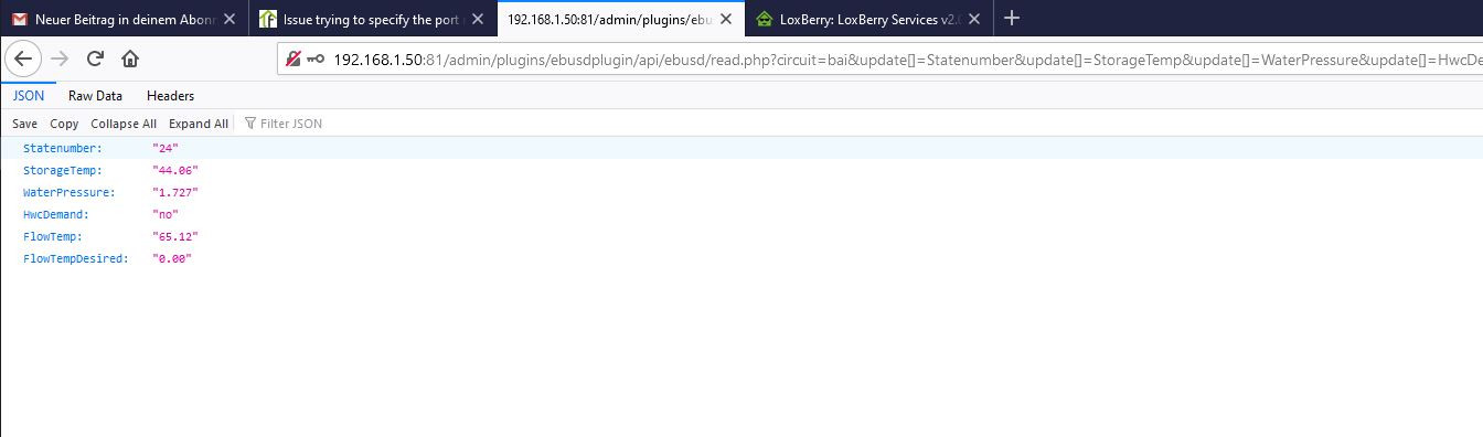

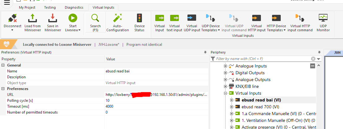

It seems that, although port 81 is specified, the Loxone tries to connect through port 80:
The very weird thing, is that when, in the URL, I remove everything that follows the port specification (in this case "/admin/plugins/ebusdplugin/api/ebusd/read.php?circuit=bai&update[]=Statenumber&update[]=StorageTemp&update[]=WaterPressure&update[]=HwcDemand&update[]=FlowTemp&update[]=FlowTempDesired" keeping only http://loxberry:Password@192.168.1.50:81) the connection seems to work, but then the plugin doesn't work anymore.
I also refer to issue that I described here: https://gitlab.com/VVlasy/loxberry-p...usd/-/issues/2
Anything I am doing wrong?
Thanks in advance,
