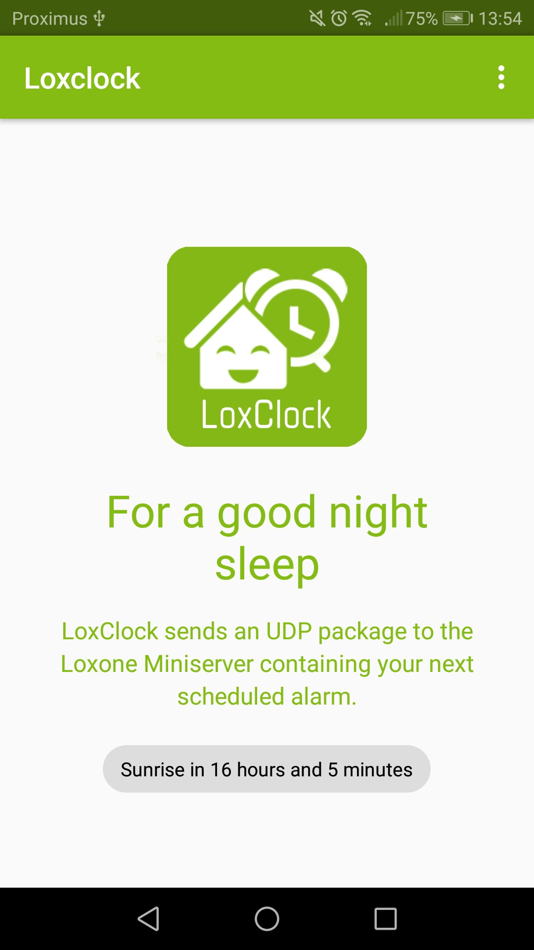

    Hi fellow Loxone users,
    I'm very proud to share my first ever android application: LoxClock.
    Klicke auf die Grafik für eine vergrößerte Ansicht  Name: Screenshot_20200826-135406.jpg Ansichten: 0 Größe: 177,2 KB ID: 262723
    What does LoxClock do?
    LoxClock takes over the set alarm of your android mobile phone. It sends this as an UDP package to your miniserver. Now your Miniserver knows exactly when you are going to wake up.
    There is already a Alarm build in the Loxone config, what's the added value?
    I'm using the alarm clock on my mobile phone already for more than a decade. I'm so used to this way of waking up, that I do not want to use a other system.
    This app combines my way of waking up to my smart home.
    Since the Loxone Miniserver now knows exactly when you will wake up, it can also perform actions prior to your alarm. How nice is that?!
    Okay, where can I find the app?
    Update September 2nd, 2020: The app can be downloaded from the Android Playstore.

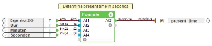

    How to set up Loxone Config?
    - First Determine the current time in seconds. Create A Marking for this value:
    Klicke auf die Grafik für eine vergrößerte Ansicht  Name: present time.JPG Ansichten: 0 Größe: 22,2 KB ID: 262724

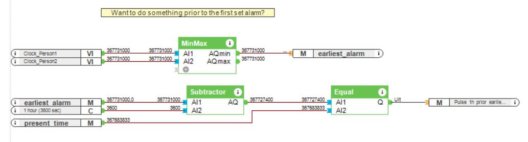

    Check the earliest alarm. Based on this alarm you can perform actions prior to the alarm goes of:
    Klicke auf die Grafik für eine vergrößerte Ansicht  Name: determine earliest alarm.JPG Ansichten: 0 Größe: 49,7 KB ID: 262725

        I've already noticed some items:
        1- If I'm going to change the alarm clock on the Cellphone, then I need to click-execute LoxClock, so that the new time will be sent to the Miniserver.
        2- If the Person 2 does not have any alarm set, then the MIN/MAX block will return 0, because the time for the Alarm clock is 0. But I'm sure this can be fixed easily with a bit of Config further programming. J
        In Loxone Config would be interesting to customize diffent actions (handle windows shadows for ea. different room) according to ea. alarm clock.

          Regarding your second point. Indeed, the value will be zero. But I created a very simple example. I think there are Loxone users with much more experience within Loxone Config who can come up with a very nice solution.
