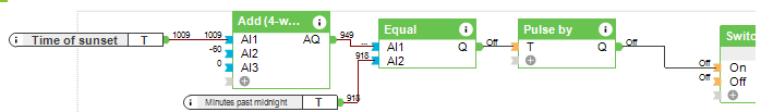

Do you have an idea how I can create a pulse for for x minutes before the sunset or after the sunrise ?

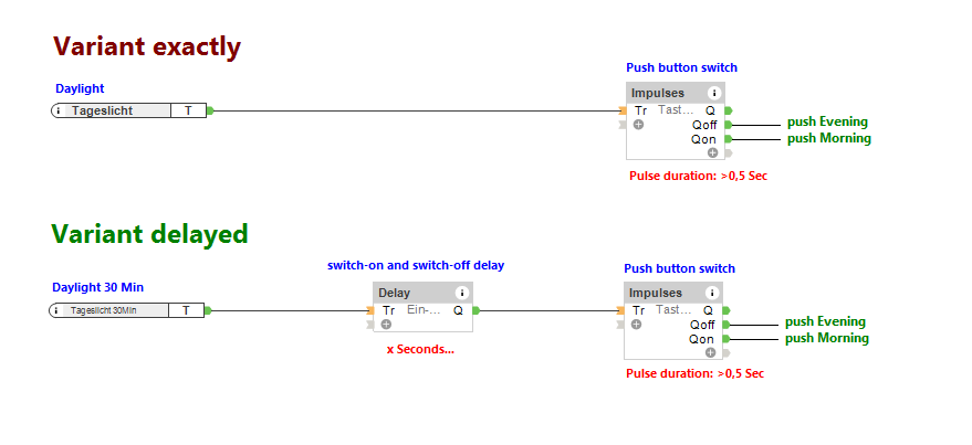

I know that we have Pulse for Sunrise/Sunset Dusk/Down but it doe not allow too much flexibility.
Also I tried to use Daylight 30 minutes , but it is On/OFF not a simple pulse.
The use case is the following :
1 hour (or x minutes) before the sunset , when the light is already lower outside, I would like to trigger down the privacy stores.
Hello all.
I am trying to introduce a variable time to switch on the lights in my courtyard in the morning before sunrise. The idea is that the lights will go on about 1 hour before sunrise, and after about 1 hour be turned off via the KNX daylight sensor. I have arranged the Loxone time sunrise, combined it with an Loxone ADD
