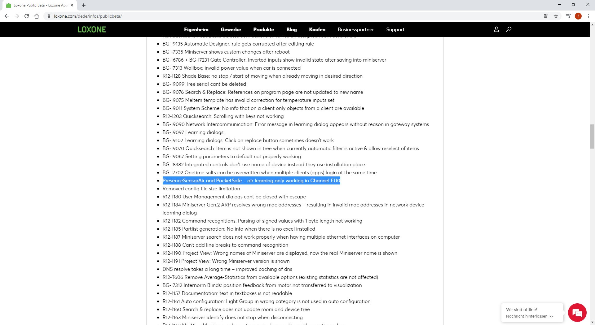

Hi everyone. I'm writing to know if you too have recently had problems with the air presence sensors.
They are able to acquire only on frequency 0 (which on the config is written as US but instead is EU).
In the latest beta (11_3_1_15) it seems that the problem was fixed but it remains.
Does anyone have a solution to the problem?
Thanks in advance!
I had some issues with the presence sensor too. In the config I was unable to learn them on, just as said in the known issues. I finally used the learning function in the app, the app crashes though, but the sensor occurs in the config anyway.
