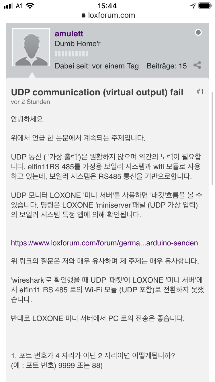

    UDP communication ('virtual output') is not possible. I am using elfin11RS 485 as a home boiler system and wifi module, the boiler system is based on RS485 communication.
    UDP monitor LOXONE'mini server' allows you to see the'packet' flow. The commands are verified by the boiler system specific app in the LOXONE'miniserver' panel (UDP virtual input).
    https://www.loxforum.com/forum/germa...arduino-senden
    The question in the link above is very similar to me and my subject is very similar.
    When I checked with'wireshark', UDP'packet' failed to switch from LOXONE'mini server' to elfin11 RS 485 Wi-Fi module with UDP
    Conversely, transfer from LOXONE mini server to PC is good.
    1. What if the port number is 2 digits instead of 4 digits?
    (E.g. port number) 9999 or 88)
    2. What are the possibilities of a particular port block?

    Hallo. Über die UDP-Kommunikation wird das RS485-Slave-Gerät gesteuert. Das Gerät ist rs485 to wifi (elfin11). Verbindungsdiagramm: rs485 slave ------> rs485 to wifi (UDP socket) ------------>> (IP 192.168.219.104/80) --------> loxone miniserver (IP192.168.219.102/8899) Wenn ich den Befehl direkt vom

        Die Verwendung einer statischen IP löste dieses Problem.
