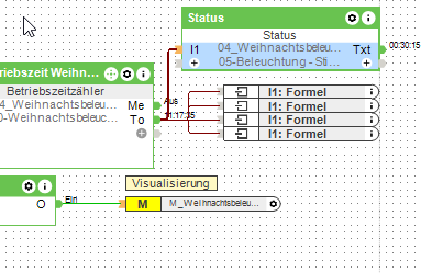

          • klexi
            • 05.01.2020
            • 45
            Hi, I would like to add the value of the time counter to the log file. If I connect the status block (<v1.m>) directly to the time counter, the resulted value is not correct. If I split the value of the time counter to hours/minutes/seconds and use the result as inputs to the status block (<v1>h:<v2>m:<v3>s), the value will be correct.
            • Tico
              • 31.08.2016
              • 1035
              The Status Block with <v1.m> can't use seconds as a direct input. The <v1.m> uses EIB format, which groups a time value into three distinct bytes. The attached picture shows how to convert current time to EIB time.You will see the value from the Time Formula changing every second. But this is not 'seconds' per se, but a related value.
Ansichten: 563
Größe: 35,2 KB
              • klexi
                • 05.01.2020
                • 45
                Hi, I do not understand. What do I have to change in order to show the correct time?

                • Tico
                  • 31.08.2016
                  • 1035
                  The output of 'To' needs to be in seconds. ie. Set the Time Unit (Tu) in the Operating Time block to 0.
                  The seconds value needs to be manipulated to a value suitable for use by the Status Block and the EIB format <v1.m>. The formula is as follows -
                  INT(I1/60/60)*256*256 + INT(I1/60 - INT(I1/60/60)*60)*256 + (I1 - INT(I1/60)*60)
                  This works fine except when the 'To' output becomes greater than 1 day. When this occurs, Loxone adds a day description in front of the Hr:Min:Sec. This is pictured in the second Operating Time Counter that has run for many days.
                  Klicke auf die Grafik für eine vergrößerte Ansicht  Name: EIB Format.png Ansichten: 0 Größe: 35,3 KB ID: 369248
                  Zuletzt geändert von Tico; 01.12.2022, 23:23.
