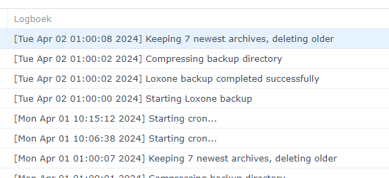

In the example above you mounted /usr/loxone_scheduler/backups, while your Github Readme explains /backups.
The following issue right now is that my docker logfile mentions a daily completed backup. though the given location (/backups) does not contain the backup files.
So is the reason a bad mount? a R/W issue? Or perhaps a leap in the logfile that the backup file failed indeed?
I have to take a look at it, i made some changes but it works for me. Can you try to mount a directory just like I did? Also you can start a console from that container amd check if the backup is there at the /backups folder
Hi, I started a console and The Backups folder was empty. I changed config based on your latest post and rescheduled the job. Now it seems to work properly! Maybe you should change the readme file?
