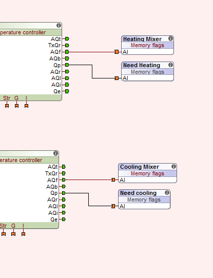

    Hi all,
    You find here the video of Loxone - here.
    Since almost a week I'm trying to figure out how it works and to put in practice.
    To heat or to cool, I had to put two block-functions. Is that so?
    Did already someone of you try it?

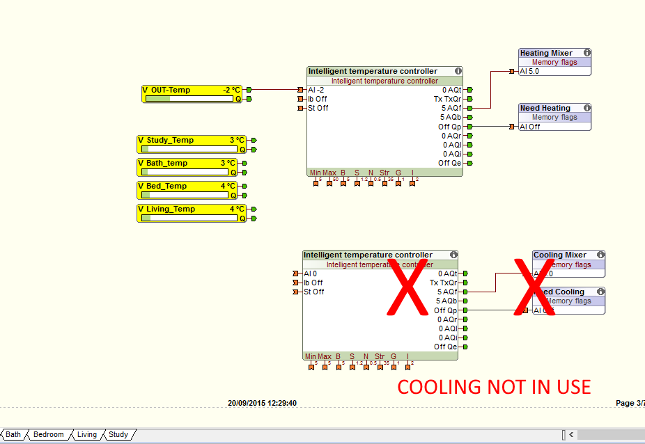

          Let's say the temperature dropped to -2 °C (outside) in the middle of Septembre. According to the Miniserver we are still in the cooling period.
          Let's say also that the temperatures in the house dropped as well to 3 or 4 °C. There is no heating. I've to devise a system so that the heating may go on.
          So I did a simulation with the Intelligent Temp. Controller. Still the same it doesn't start the heating system. I think it is still connected with heating/cooling calendars.
          IMHO these calendars are useless.
          Does someone have another opinion?

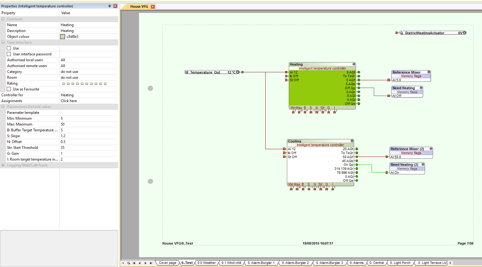

            • duncan
              • 363
              i got some guidance from loxone and got this block to work, but discovered an issue which would stop it being useful as a central drive for manifold pumps and boilder demand - if you swap an IRC mode from auto modes to manual heat mode, say for a boost, the ITC block switches off, and there is no manifold/boiler demand drive. you can get round this by using the boost input of the ITC, but it drives the manifold temp to the maximum, and requires memory links from each IRC back to the ITC
                Would it be possible to a screenshot of your system? Or just a generic one.
