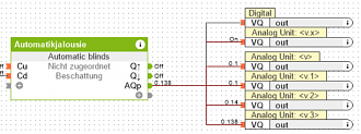

    Did you set de Display Unit to <v.3>?

    lg Romildo

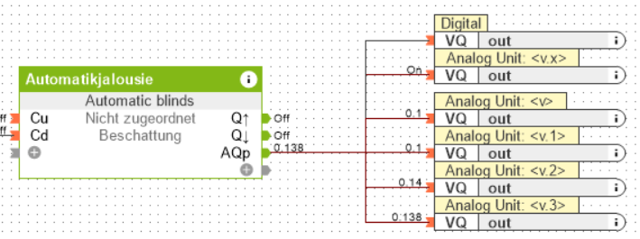

        Zitat von iopaza
        ...Maybe first, you can tell me if it's possible to have a value between 0 and 1?...
        Yes it is, but not in "use as digital output" and also not with <v.x>
        In the Simulation you can see what's happen.

        lg Romildo
