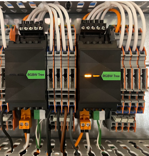

    When using a Meanwell 240W 24V DC PSU (NDR-240-24) for a Loxone RGBW extension...
    Do you guys place a 8A glass fuse before the RGBW extension?
    Or place a 2A glass fuse after each RGBW extension output?
    Or do you trust on the 10A short protection of the Meanwell PSU?​
    Many thanks.
    Some example of fuses after each RGBW output...
    Klicke auf die Grafik für eine vergrößerte Ansicht  Name: image.png Ansichten: 0 Größe: 701,6 KB ID: 425079

      Guess I go for 4x 2A fuses on the output of the RGBW extension.
      And on the input, I will trust the Meanwell 10A overload / short protection.
      I will make sure the wiring on he RGBW extension input is done to handle more then 10A
      If someone still has some input / feedback, all welcome!
