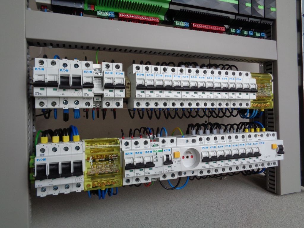

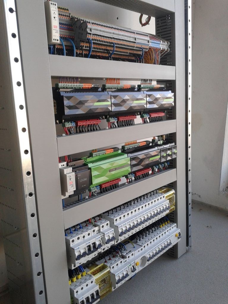

    Hi all,
    My name is Dawid.
    I have been watching this forum for a long time - in search of inspiration.
    So far, I have found here many interesting information.
    I would like to present my last peace of work - all comments are welcome.

        Looks great! Can you share your materials used? I'm especially interested in the cabinet enclosure.
        • experde
          • 65
          Hello David,
          your installation looks good.
          I will see two Problems. 1. we will you change the SD Card? 2. you have no Reserve in your installation.
          best regards, Steffen

            The list of materials is:
            automation: Loxone;
            switches: Eaton;
            cabinet: Schrack Technik (family: Modul 2000);
            terminal blocks: Phoenix Contact;
            1. Indeed - this is a small fault.
            When I was designing the cabinet (on the CAD software) - I didn't thought about it.
            I learned about it, when I the cabinet was finished lying on the table due the pre-programming and I needed to replace the SD card.
            The replace of the card is possible but could be simpler...
            2. Indeed - we had a limited space for the cabinet and we used it to the maximum.
            If we need to add something - we will use the Loxone Air.
            Kind regards!

              Dear Dawid,
              Can you explane why you have two voltage protectors? I cannot see the wiring so I'm very curious
              Simon
                Hi Simon,
                I don't understand which device You are asking about - in these cabinet we don't have any voltage protectors (if You mean SPD)
                ​​​​​​​Kind regards!

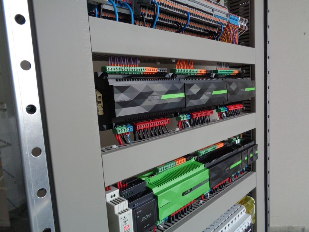

                  Hi Dawid
                  Could you tell me which phoenix contact terminals you are using? There seem to be a few different types.
                  Thanks
                  Rob
                    Hi Rob,
                    for the signals we are using: PTRV 8 BU/RDWH and PTRV 8-PV /BK.
                    For other: PT 4-PE/3L, PTI 4-PE/L/N, and the terminals from UT family.
                    Kind regards!
                          Hi David, nice work, looking very neat and tidy!
                          Can you tell me if you tried to keep the 230V AC cabling apart from the low voltage (24VDC) cabling and if so which side of the cabinet you run it.(in the vertical trunks?)
                            Hi heriek,
                            we are trying to separate the 230VAC from low voltage (on the left side goes the main voltage on the right the 24VDC).
                            According to standards: there is a possibility to put two voltages in one trunk but the insulation of the cables should be the same.
                            Kind regards!

                              Fragment of our last Loxone cabinet - in attachment.
                              On the picture - automation section...
