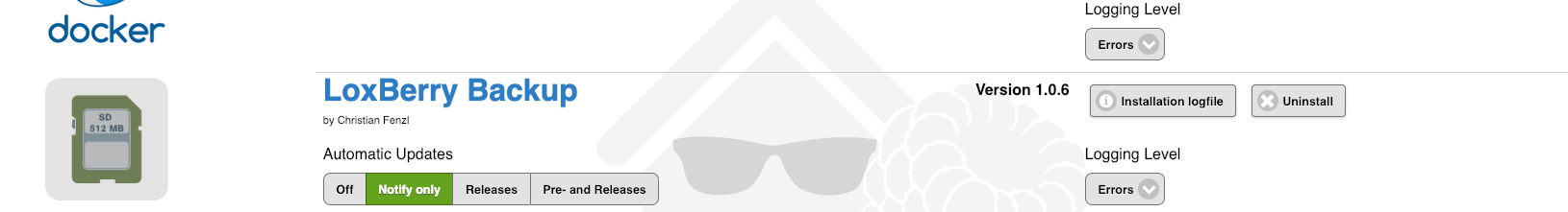

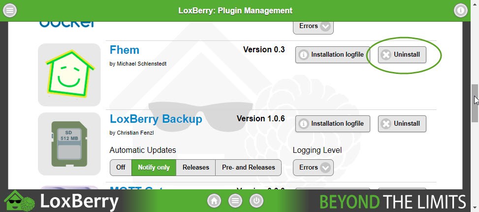

When I delete them and reboot they come back, any ideas please.
Removing plugins
What means "they come back"? Could you explain that a little bit more, please.🇺🇦 Hilfe für die Menschen der Ukraine: https://www.loxforum.com/forum/proje...Cr-die-ukraine
Ok, this is strange. I will send you a PN for a Remote Session. Home you have LoxBerry Version 1.4.0.2 If not please upgrade. Then please go to the Remote Support Widget and enter the Support Key which I have send by PN. I also need your loxberry- and Root-Password.🇺🇦 Hilfe für die Menschen der Ukraine: https://www.loxforum.com/forum/proje...Cr-die-ukraine
Ok, that's really STRANGE. Could you please connect the LoxBerry again in the Remote Widget, please.
Well, I haven't seen this before. Your LoxBerry also do not safe any files. If you change something in the LB Config and safe it, it is saved to the SDcard. After reboot, all changes are gone.
Just to make it sure: This is a RaspBerry (Pi3?) and no Docker Image or something like that?🇺🇦 Hilfe für die Menschen der Ukraine: https://www.loxforum.com/forum/proje...Cr-die-ukraine
Well, I am afraid you have to reinstall it. I cannot find any problem with the filesystem or something else. But it does not save any files. So you will not be able to install new plugins or safe any configs.🇺🇦 Hilfe für die Menschen der Ukraine: https://www.loxforum.com/forum/proje...Cr-die-ukraine
